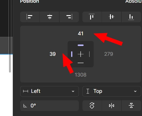

When manually updating the values on the aboslute position values left and right when aligned to the top and left inside a section doesn’t work.
How to reproduce:
  • Create a Section ouside the pages on Figma sites
  • Add a frame inside the section
  • Now select the framte, change the top and left values, click enter/return to apply
  • The value revert to the previous ones.
  • If I drag the frame the values upate in real time.

Hi there,
Thanks for flagging this! I could also reproduce this behavior, so I shared internally. I will get back to you when I have anything I can share with you.
Thanks for your patience.
Toku
