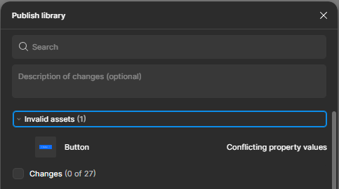

Daniel Nicholas
Mar 25, 2025 12:14 AM UTC
Check for conflicts within the component properties as these will stop the components from publishing.
The easiest way to find this is to right click on a component or component group and select Main component > Publish selected components.
This will bring up the ‘Publish library’ model in which it lists any “invalid assets” and the reason why they are invalid. In this instance it is because some of the components in this component group have conflicting (the same) property value
