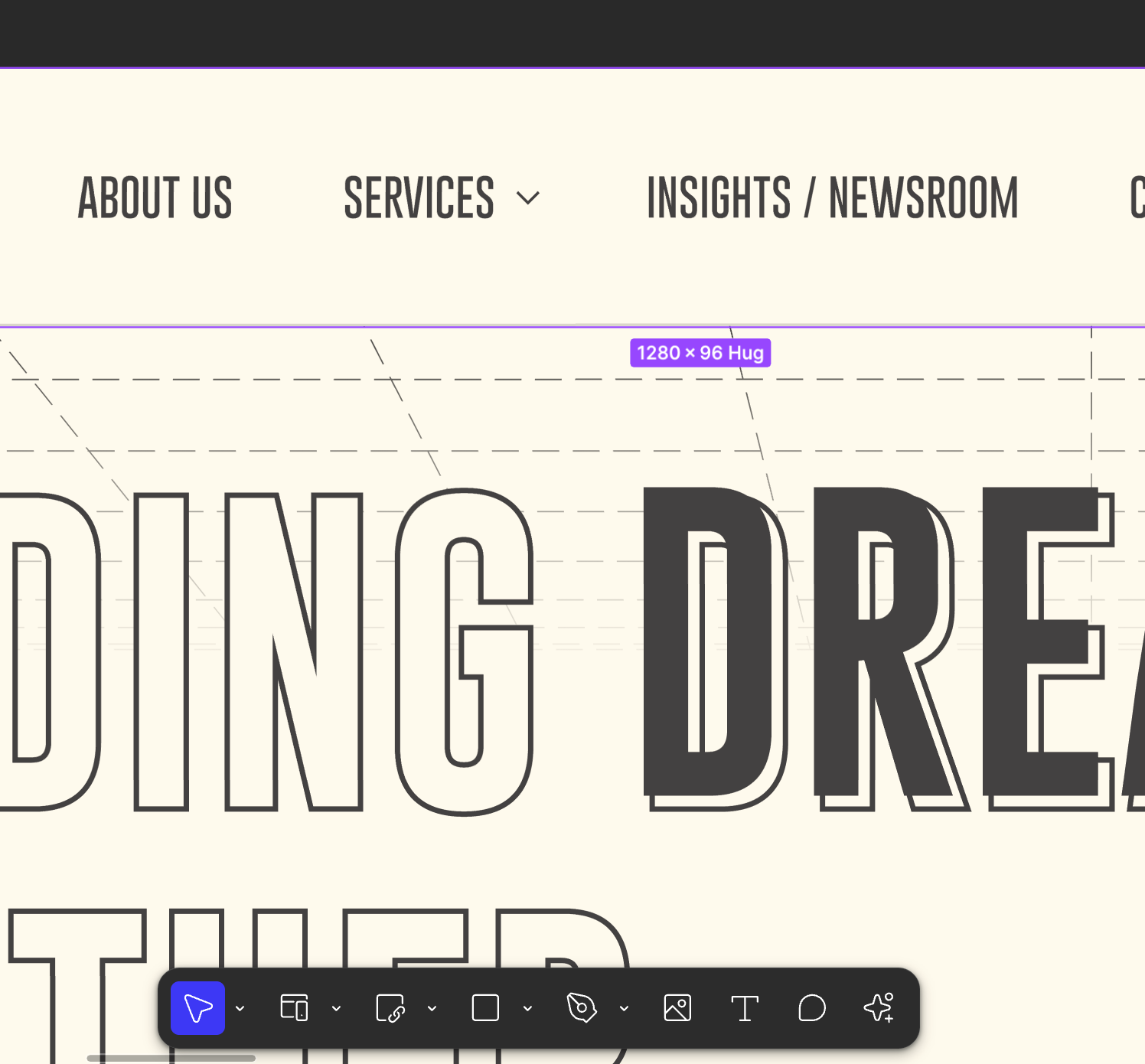

I tried copying my design into Site. It looks good in this editor view with Gobold from Google Fonts:

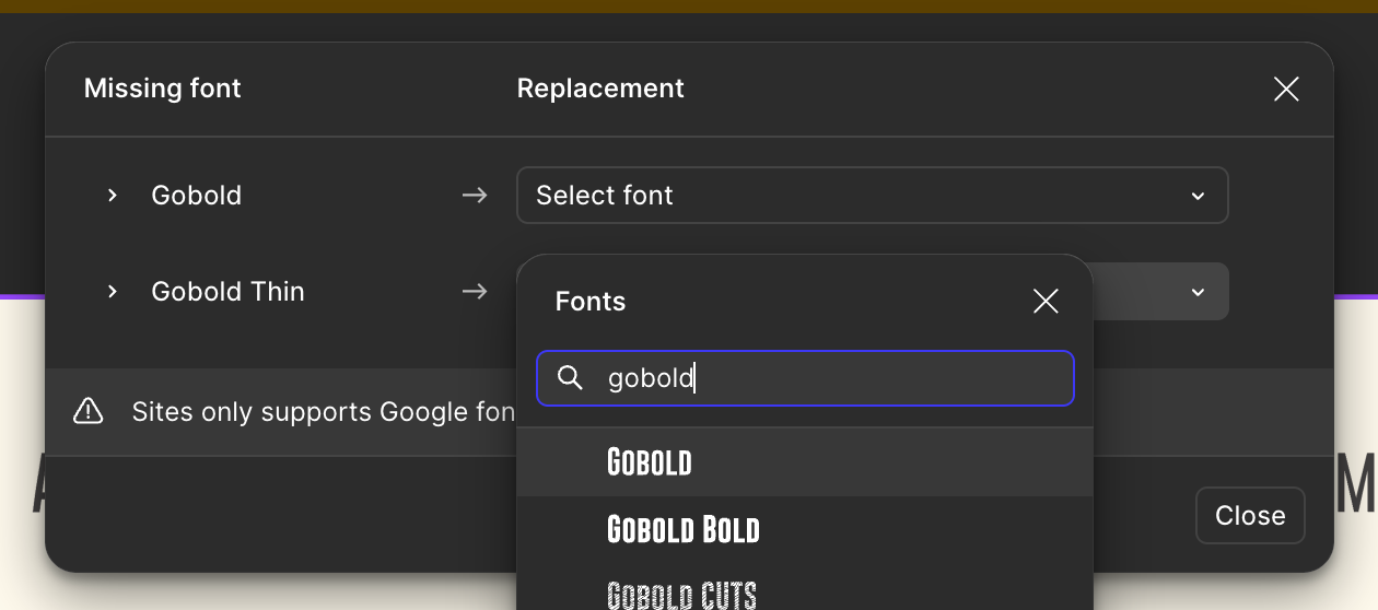

But there are still Missing Fonts notices:

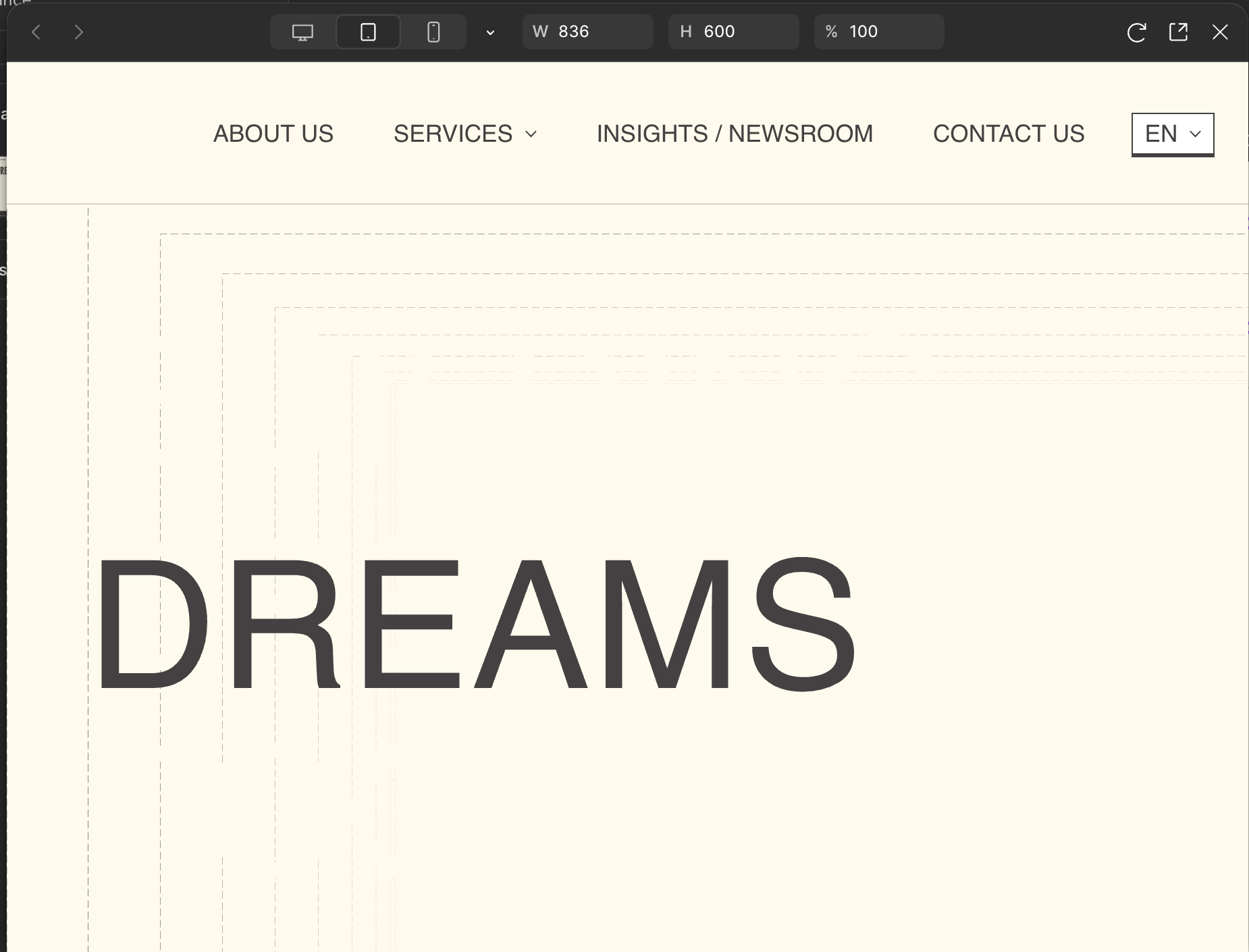

I replaced so many times but it could not show up in preview:

Best answer by Nellya
Gobold is not a part of Google Fonts, that’s why it’s not available in Figma Sites

@y_toku Thank you for your reply. Unfortunately it didn’t make a difference. Instead it lead me to try to  reproduce the problem in different browsers.
Chrome: Fonts displayed not correctly
Brave: ( based on the Chromium web browser): Fonts displayed not correctly
Figma App: Fonts displayed not correctly
Figma App Beta: Fonts displayed not correctly
Safari: It works correctly! the fonts are displayed just right! 🤔
Maybe we get closer to find a solution. I will submit the bug and let you know.
