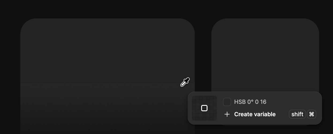

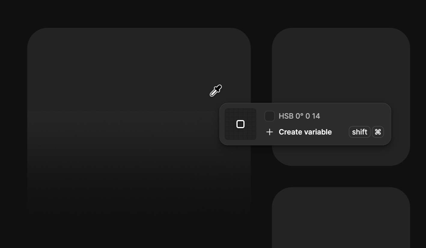

Damian_Oczki
  • Active Member
  • October 14, 2024
They’re optical illusions. The white stripe isn’t really there; you can check it with the eyedropper tool, or observing that the bottom part is already pure white, so there can’t be a “more white” stripe there. As you can imagine, the “cross” illusion is just two of those effects, overlaid on top of another.
The illusion is caused by a sudden stop of the linear gradient, causing our eyes/brain to amplify the edge’s contrast. This can be reduced by changing to an easing gradient.
There are a few resources how to achieve this:
It appears that there are some Figma plugins for this, too:
With those plugins, you can compose overlaid gradients without the “cross” illusion in the corner:

Well this is definitely not an optical illusion. The color picker is picking up a lighter color on the transparent side of the gradient.
Looks to me like Figma is using some sort of noise filter to better blend gradients and this is producing lighter pixels on the transparent side.

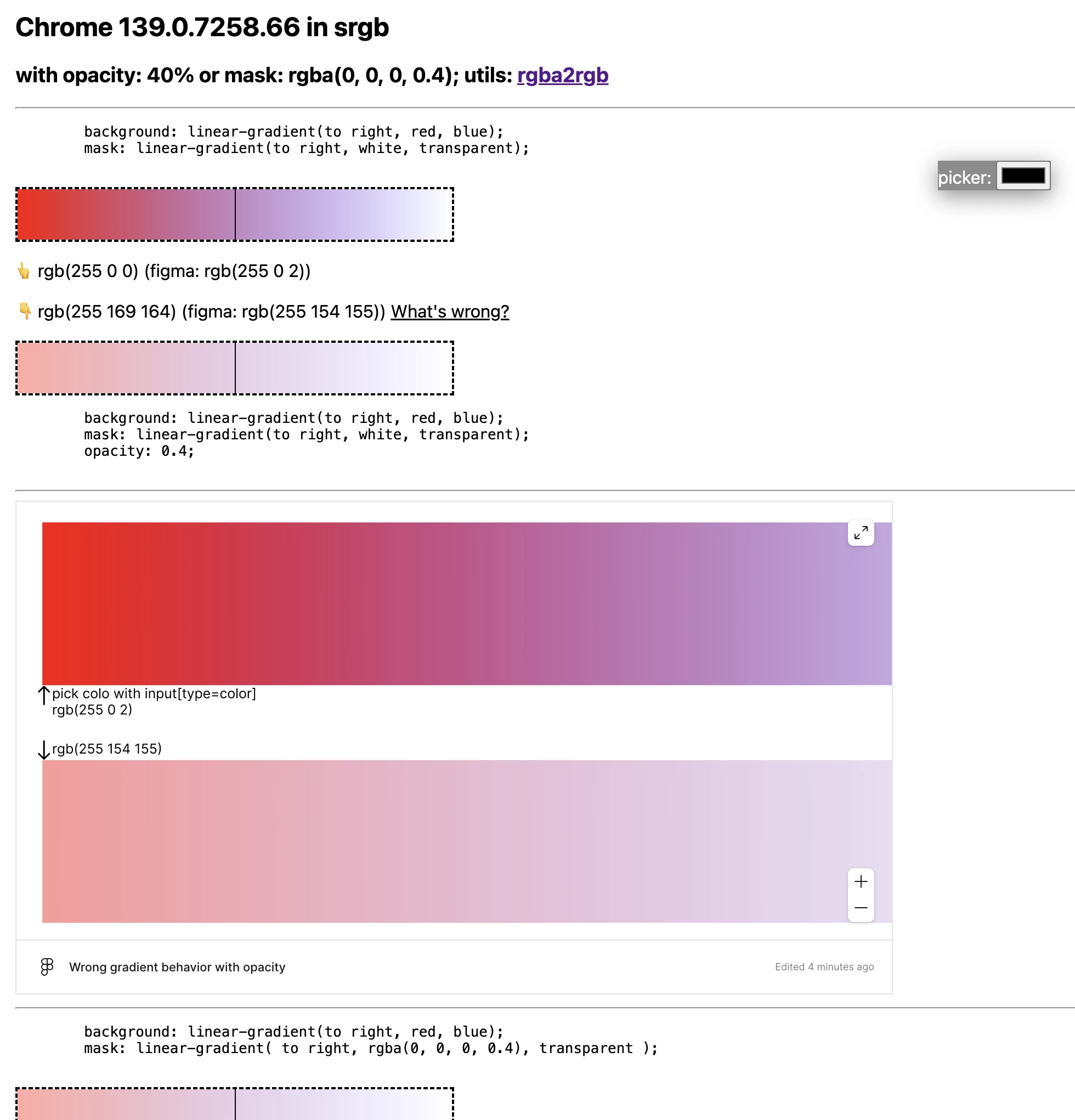

JamesCurtis
  • New Member
  • August 14, 2025
@Damian_Oczki thx. It's very helpful to me.
However, during my usage, I also discovered a problem. If we add transparency to their parent nodes again at this time, it will once again cause the problem to occur (regardless of whether the developers use masks or not).
demo: https://stackblitz.com/edit/stackblitz-starters-nzhj5ffb?file=index.html

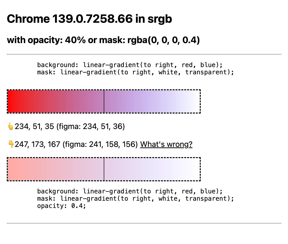

JamesCurtis
  • New Member
  • August 14, 2025
Sorry, due to the issue with the display mode, I will use the Chrome Color Picker to re-select the color values.

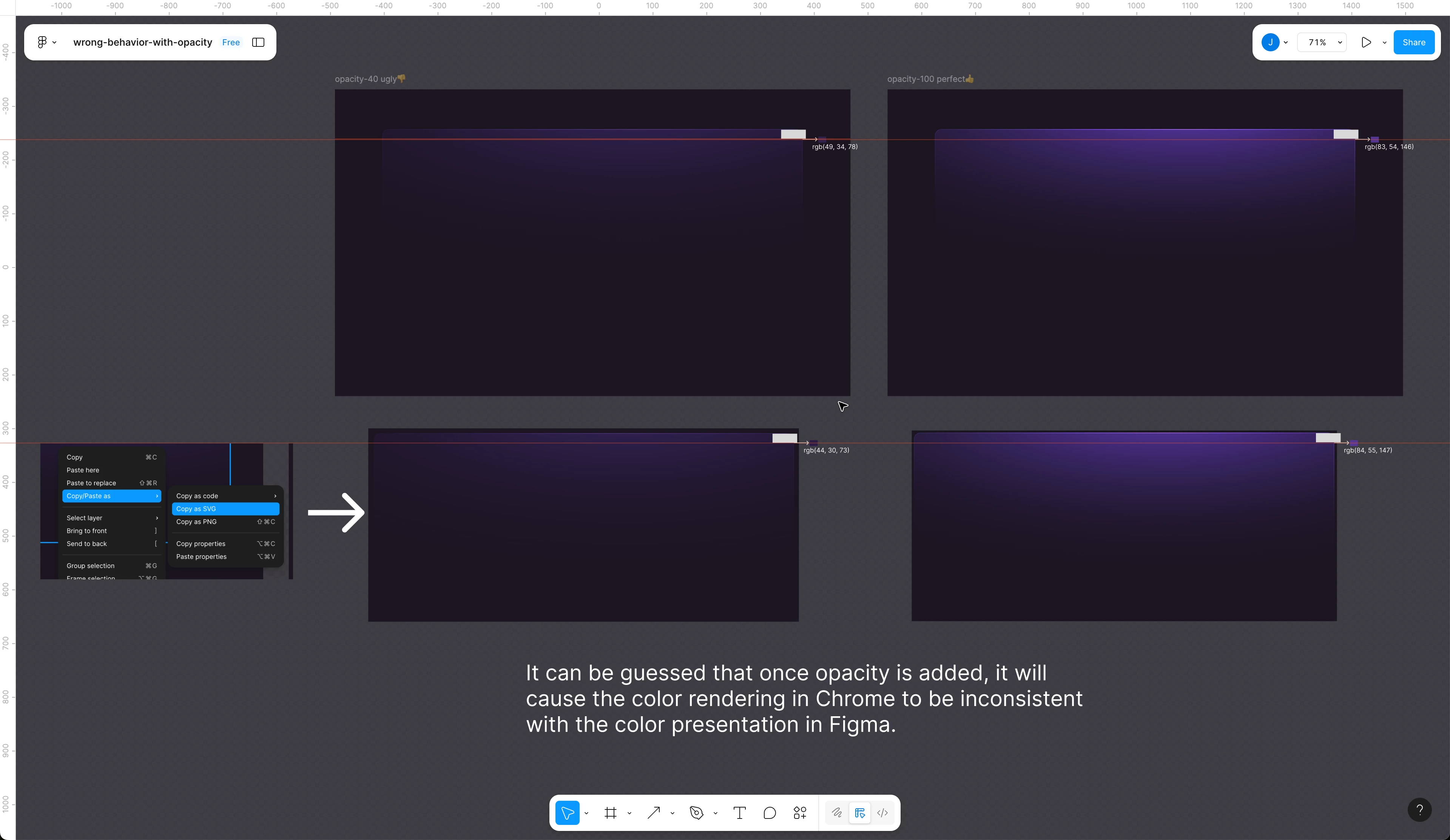

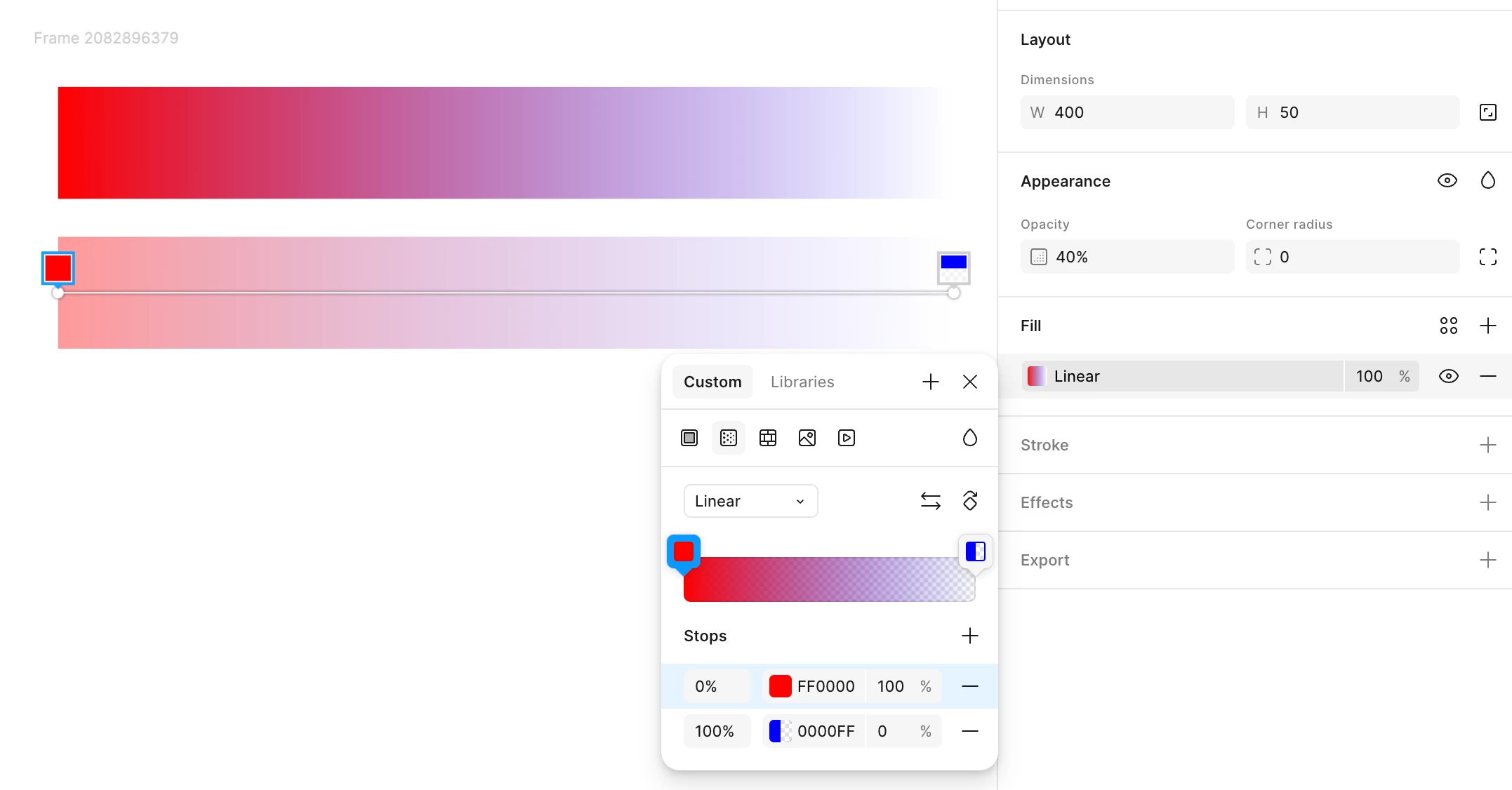

JamesCurtis
  • New Member
  • August 14, 2025
@JamesCurtis Hi guys~
I've figured out what's going on. Damn Apple! Just use an external display and change the color profile to sRGB (chrome://flags/#force-color-profile has no effect on me)
Chrome Transparency Bug
However, I noticed that after exporting the SVG from Figma, the rendering result in Chrome is indeed inconsistent with the one shown in Figma itself.
https://www.figma.com/design/osOlXAWKtHz2ArjdZHb8D3/wrong-behavior-with-opacity?node-id=0-1&t=TvvIKQcBC1tdC38W-1
link https://help.figma.com/hc/en-us/requests/1472060
