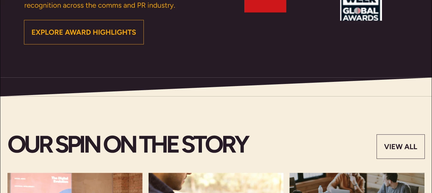

Thin gray line between the frames in the prototype mode
Hi. I have a question, is it my error or is it more of a rendering of the image when prototyping? I have a project, I divided the website sections into individual frames. I then “wrapped” these frames into one large frame. They are aligned perfectly every single pixel. Unfortunately, in the prototypes view I occasionally get such a thin gray line between the frames as below in the screenshot. How to deal with this?

I have noticed this behavior when open the Preview popup and the window scale is smaller than the original size.
Are you facing this issue when you open the prototype on in present mode?

Yes agree with most here, this has been going on for quite some time. I get around this by adding a background colour (usually white) to the main frame (page), this will fill in that line. If you are designing a dark page, then add a dark colour background instead of white.

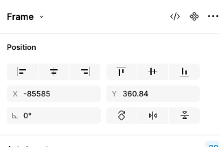

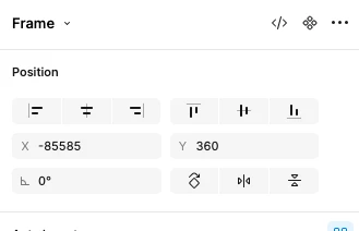

This seems to occur when elements have split pixel dimensions. In my case, I had a page built with autolayout, so all components stack vertically. Pretty standard page builder type stuff. I had a group further up the stack with a height of 778.4px. Setting this to a full value (either by tweaking the elements inside the group, or setting the height of the group itself) fixed the issue further down the page.
