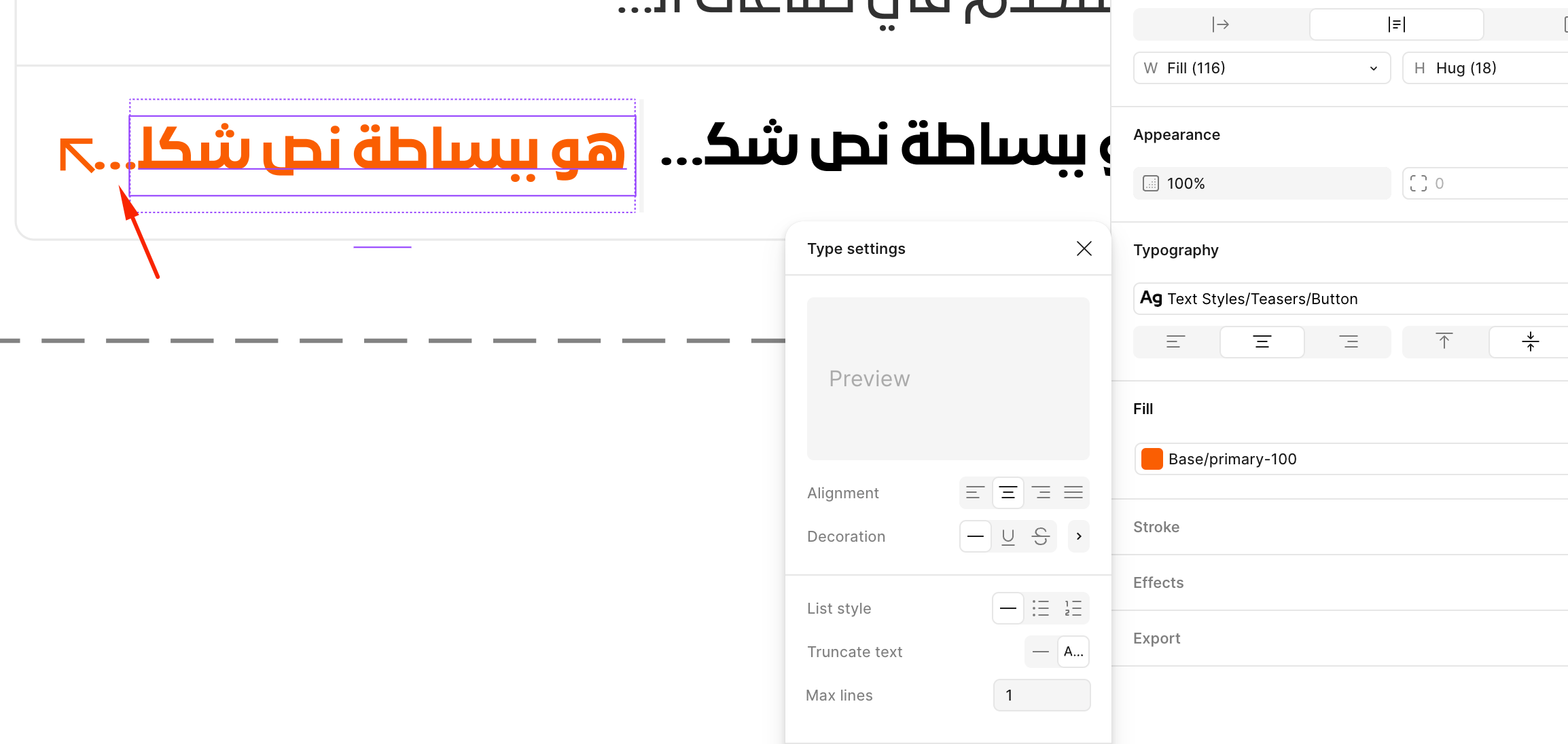

Ori_Solomon
I have this issue with RTL fonts the the 3 dots are overflowing the container. dose anyone encounter this issue and can help? (left, center and right alignment as well)
