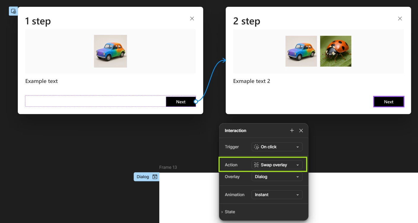

I've run into the same situation a few times and found that using Swap overlay between dialog steps works well. I set the first dialog as Open overlay and then use Swap overlay for the next ones. It keeps the background consistent and reduces the number of screens if the backdrop doesn’t need to change.

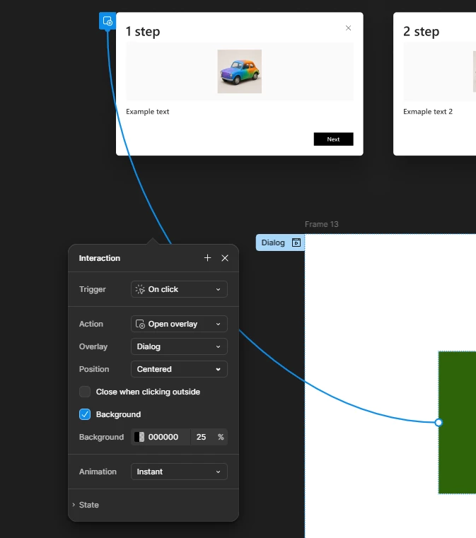

Thanks alot for responding, I got the 2nd part where we continue to use Swap Overlay property for rest of dialogs, but could you pls explain the first part where you set the first dialog as open overlay, I cant understand how do I make that work, do I need to add that property to background frame or to the dialog  itself?

You can do it by adding the Open overlay interaction to a specific element like a button. I usually set it up as shown in the screenshot, with the position set to Centered and background enabled to better simulate the typical dialog behavior.

Thanks alot for the help, now the flow looks cleaner without requiring to manually add background in each frame, I also found out that a better way to start the flow is to add “Mouse Enter” “or “After Delay” trigger, this way we trigger the flow to start naturally.
