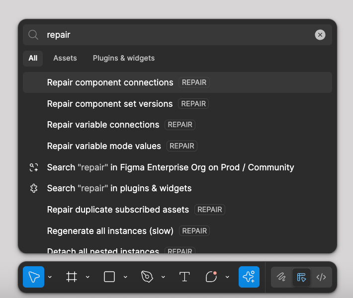

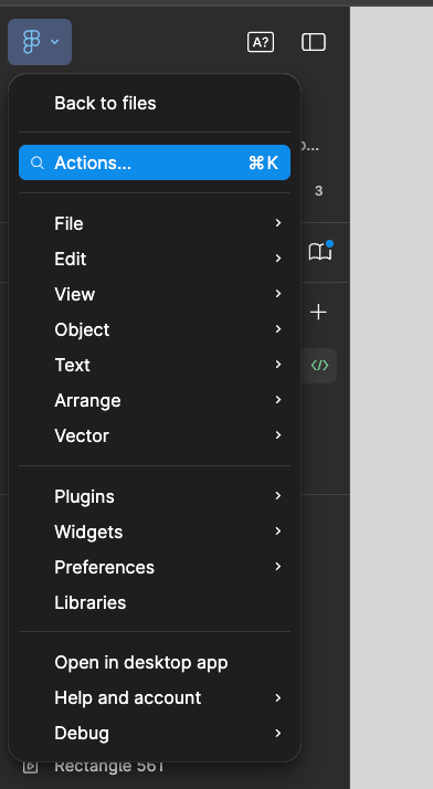

  2. Try using “Repair component connections” command in Quick Action. This command has a similar affect to fetching the most updated version of the main component, without you having to manually change and re-publish the main component and accept updates in subscribed files.
Please follow these steps:
  1. Open the file with the affected instance and select that instance.
  2. Click the main dropdown menu (the Figma logo) in the top-left corner to access the “Actions...” search bar.
  3. Search for "Repair component connections”
  1. Run this command
If that still doesn’t help, feel free to submit a bug report here, our support team can investigate it further.
