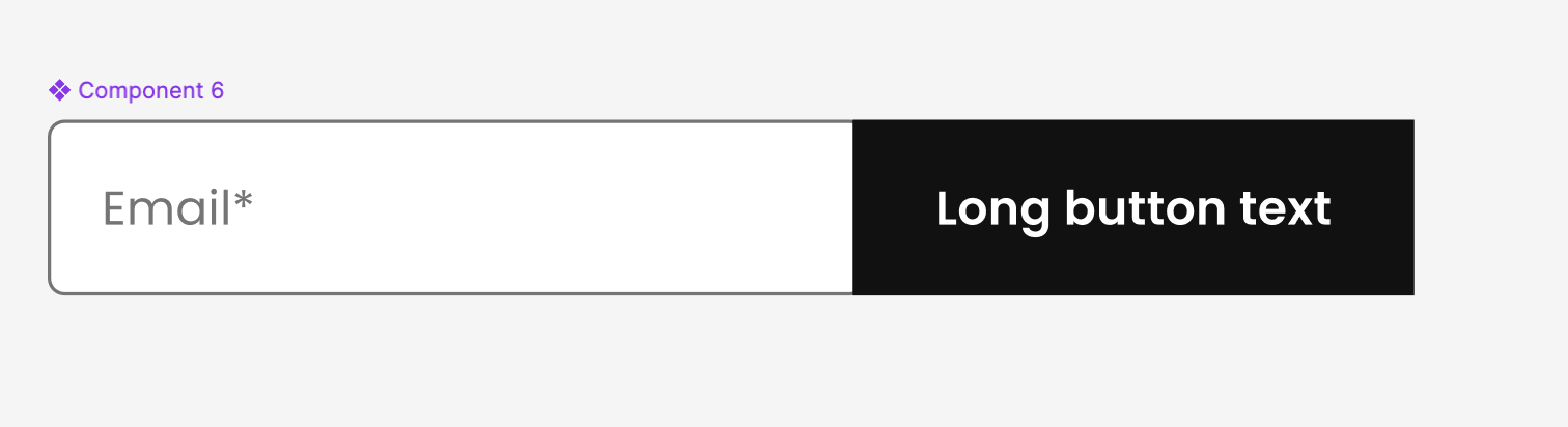

I created this form field. I want the field length to be adjustable, while keeping the button the same size and at the end. However, when I resize the field, one of two things will happen:
Button stays the same size, but doesn’t move to be at the end of the field.
Button moves, but changes size.
How should the component be set so that the button has a fixed size but dynamic position?

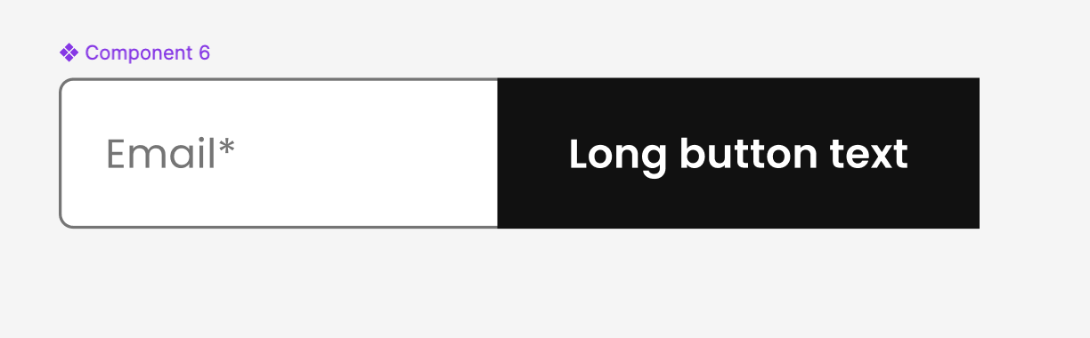

​@Raphael_M ok I found setting the button to right and form field to left+right has the desired resizing effect. However, this created another problem:
I want the button to be set so that if the label is updated, it expands away from the field as shown above. But with the button set to right, it expands into the field.
The button only expands away from the field if it’s set to left, but then it won’t move when the field is being resized. Is there a way for the text and button to have like opposite constraints?
