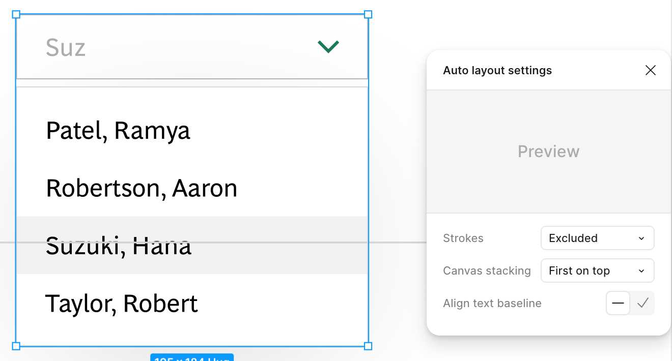

I’m assuming that your are using an auto-layout frame to vertically space the row of your table. If you select this frame, on the right panel, auto-layout section you may click on the context menu, and then change the Canvas stacking for “First on top” (as shown below) so your dropdown will always be above the one below
If you are not using an auto-layout frame, well I suggest you do, then just change the order of your element on the left panel, so the line at the top of the table, is placed at the top of the layer panel

The menu dropdown always displays behind the other items in the frame. Canvas stacking and moving the layers does not change this behavior. Basically there is no way to get this menu to open in front of other objects on the page. You can see in the screen shot that the dropdown under “SKU” (which contains “Phoenix Baker”) shows up behind the other elements on this frame. Let me know what you think @Haroll, this has been keeping me up for days lol

And this particular element can be found 3 other time (Concession Setter, Description and Concessions). I’d say these elements are inside a vertical auto layout and it’s this one which need to be set to First on top as shown below, I named this auto layout “top container” and I change its canvas stacking, so you can see the outcome before (on left) and after change (on right)
