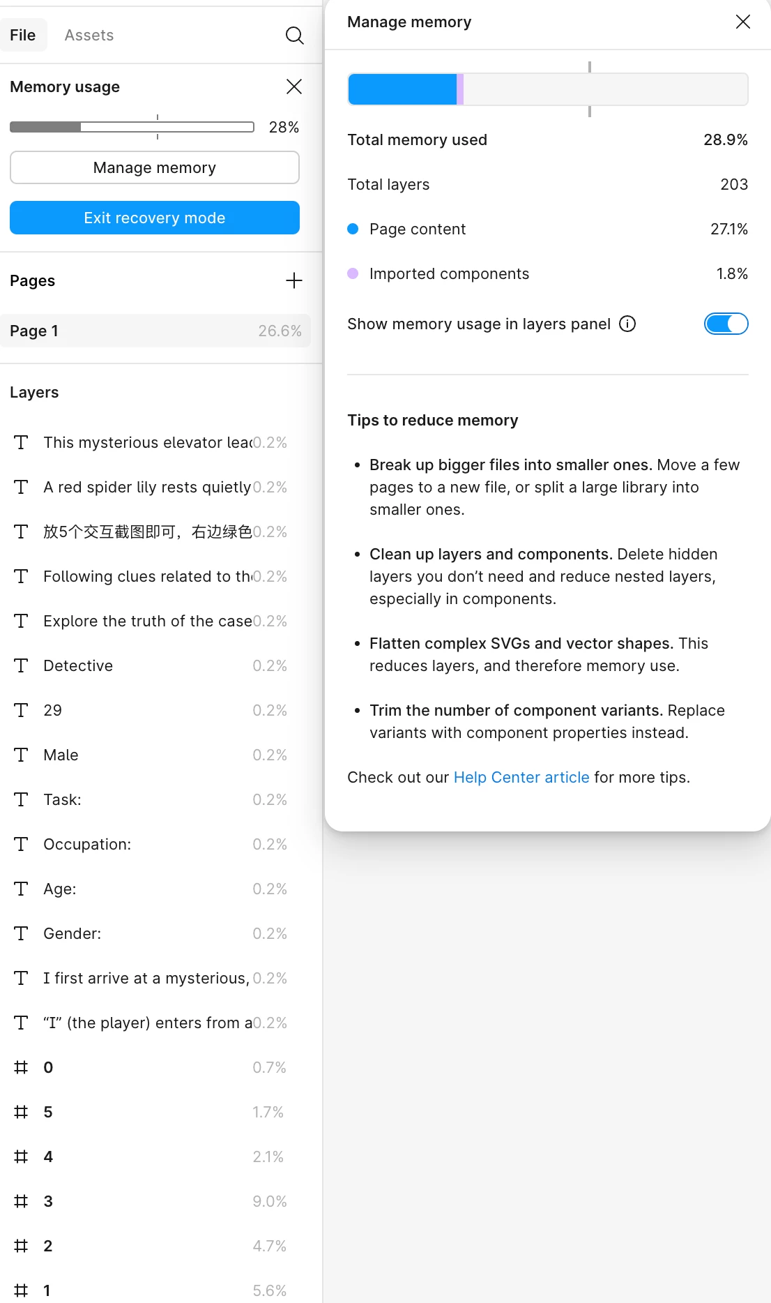

Ran out of memory usage in a small document
At noon, everything was working fine when I was using one of my documents. However, suddenly a pop-up window appeared saying “Out of memory” and prompted me to open recovery mode.
Since then, I noticed something unusual: this particular document has significantly less content than my other files, yet it keeps showing memory issues. Even after I deleted some elements to reduce the load, the file still reports that it’s over the content limit.
Strangely, a single text box with just two words can take up about 0.2% of memory, and the memory usage keeps fluctuating between 0.1% and 0.4%. Whenever I try to make any small changes, the document crashes with an “Out of memory” message and forces me to reload the page—even when the memory usage indicator shows only 29%.
This file is very important to me. Please help me resolve this memory issue—I’d be incredibly grateful!

A simple text box sometimes takes up 0.2% of memory, and other times 0.5%. This document is clearly much smaller than my other files, yet it’s having these issues. The fact that a single text box can take up 0.2% of the memory is already quite surprising and concerning.
