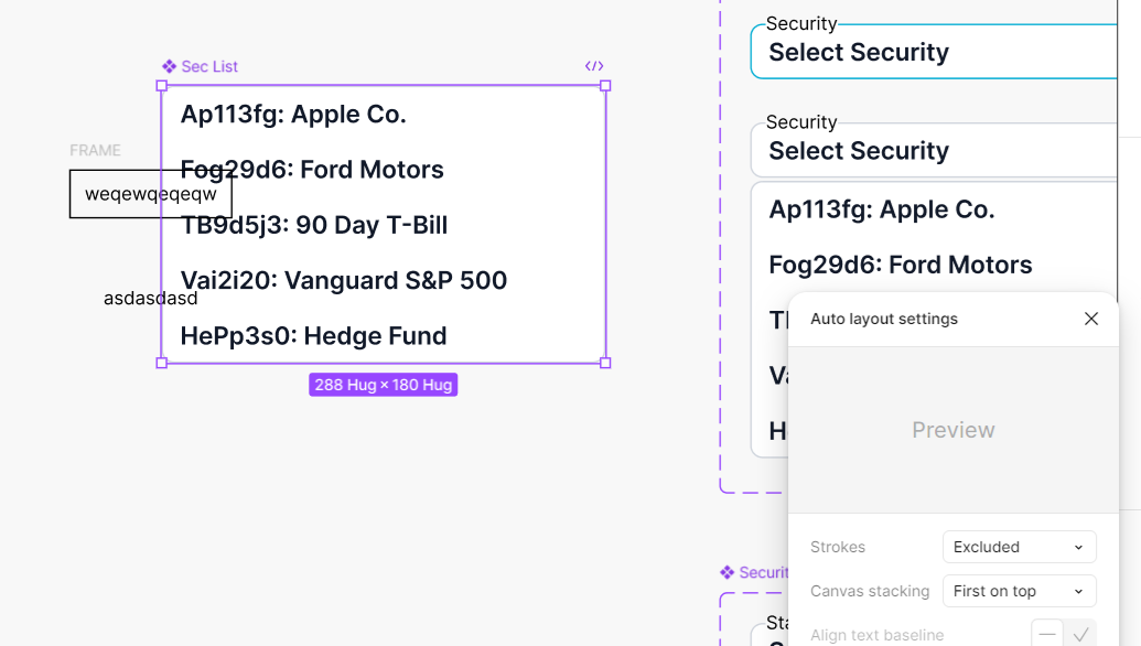

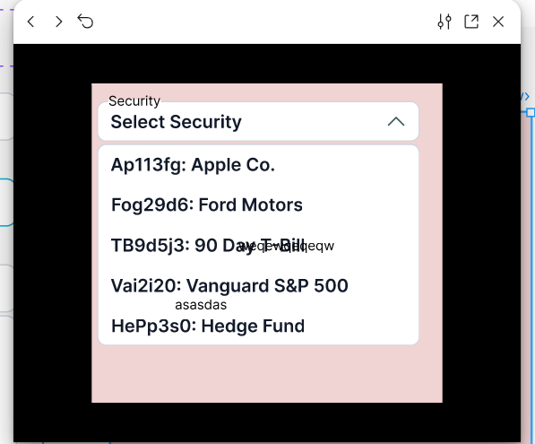

Ok, from my understanding of your design : it looks like you’ve got an horizontal auto layout with all your selects inside :
There is a frame containing on the left : a title and a description, and on the right the auto-layout aforementioned.
And this particular element can be found 3 other time (Concession Setter, Description and Concessions). I’d say these elements are inside a vertical auto layout and it’s this one which need to be set to First on top as shown below, I named this auto layout “top container” and I change its canvas stacking, so you can see the outcome before (on left) and after change (on right)
