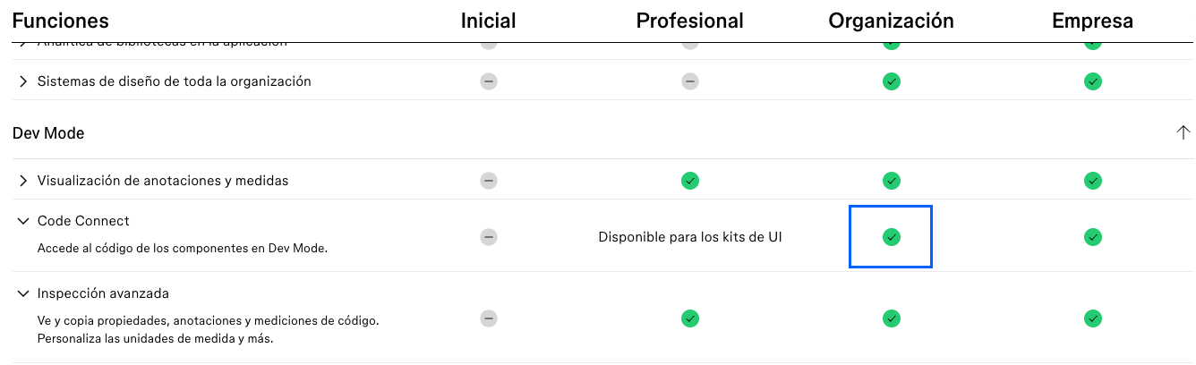

I understand that to use code connect I have to be part of a organization, which I am already, called Genexus:

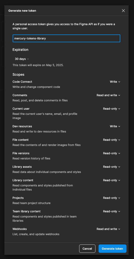

  5. Then, I went to “Settings” > “Security” > “Generate new token”.
  6. I gave access to all scopes

Then, I chated with gpt, and this is the apparent explanation:
Yeah, that confirms it — file_variables:read isn't in the list, which is why you’re getting the 403.
Figma doesn't include that scope in the regular token UI yet. To access variables via Code Connect, you need to be part of a team/org with Code Connect for Variables enabled (it's still in limited beta as of now).
As far as I can see, there seems that some scopes are missing from my list. I am already a member of an Org. I am not the owner of the Org, but I have been invited. I need to be able to connect with the variables of my DS via Code Connect. ¿What should I do to enable the required permisions?

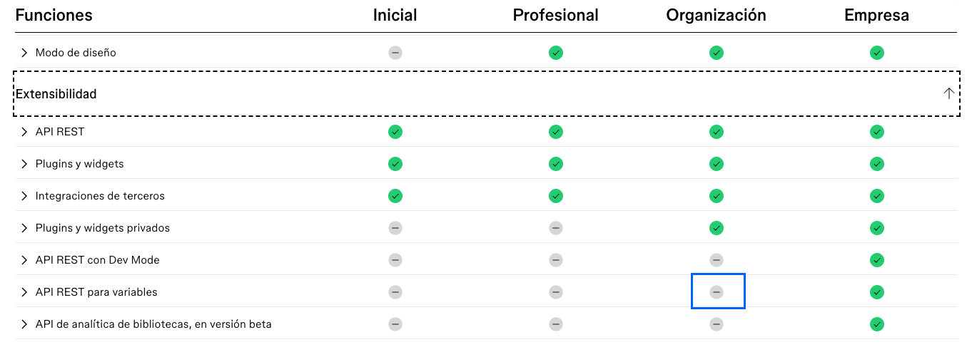

Hello! The “file_variables:read” scope is only available to members of an org with an Enterprise plan, as this plan level supports the REST API for Variables.

However, I think you are right. Even tough Code Connect is available for a organization plan. The variables REST api is only for enterprise.
