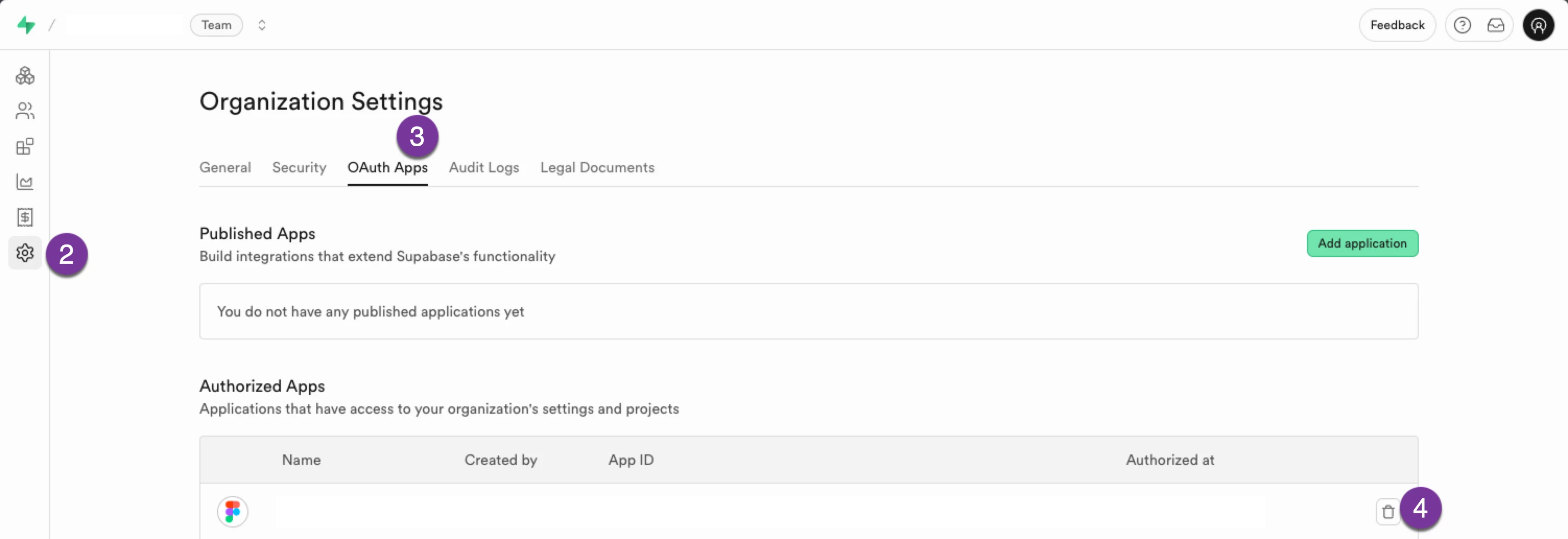

I checked in with the product team and, at this time, switching between Supabase accounts needs to be done on Supabase’s side. Here’s how you can disconnect and reconnect:
  1. Go to the Supabase Dashboard → sign in if needed.
  2. Click the settings gear icon ⚙️ on the left.
  3. Select OAuth Apps.
  4. Click the trash icon 🗑️ next to Figma.
  5. Back in Figma Make, you should then be able to go through the connection flow again.
I hope this helps for now! I’m curious if you’re able to offer more context, could you share a bit more about your workflow with this — how often you may need to switch accounts and why?

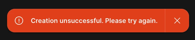

When I go to Create new project, fill in the fields, and submit, the following error appears:
Tom, could you give me some step-by-step instructions to resolve this? I would like to be able to log out so I can log back into my Supabase account and continue with the project. I have already tried some alternatives, such as logging out and logging back into Figma.

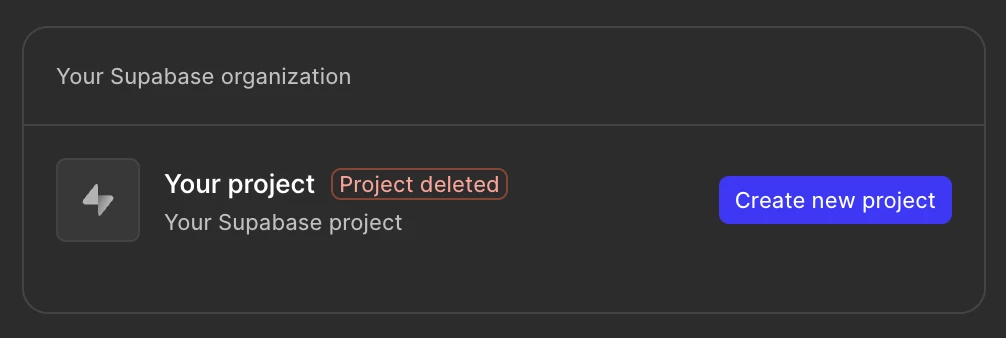

My project was deactivated by Supabase, so Figma Make pointed out that there was a problem with Supabase. However, when I go to the Supabase tab within Figma Make to resolve the issue, the first screenshot appears, which does not allow me to disconnect or anything like that. It only allows me to create a new project. However, if I try to create a new project, only an error message appears.
Now that I've disconnected within Supabase, this path of creating a Supabase project through Figma Make should no longer exist.
