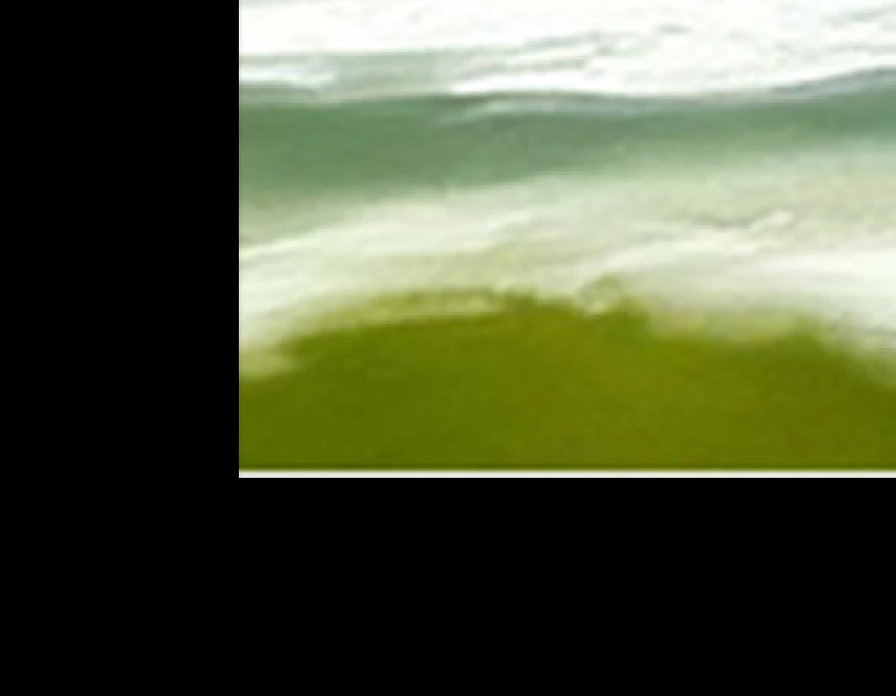

Hi all,
When i’m exporting to a JPG with a dark background, the export is adding 1px to its original size which then creates a thin white line top and bottom

Hey there, thanks for reaching out and sorry for the trouble!
This is a bug for decimal exports that our team is aware of. These white lines appear when exporting a JPG that is positioned on a sub pixel value (i.e. any value with a decimal point). To prevent this from happening, ensure that the width, height, and/or X and Y positions are on full integer values before exporting.
