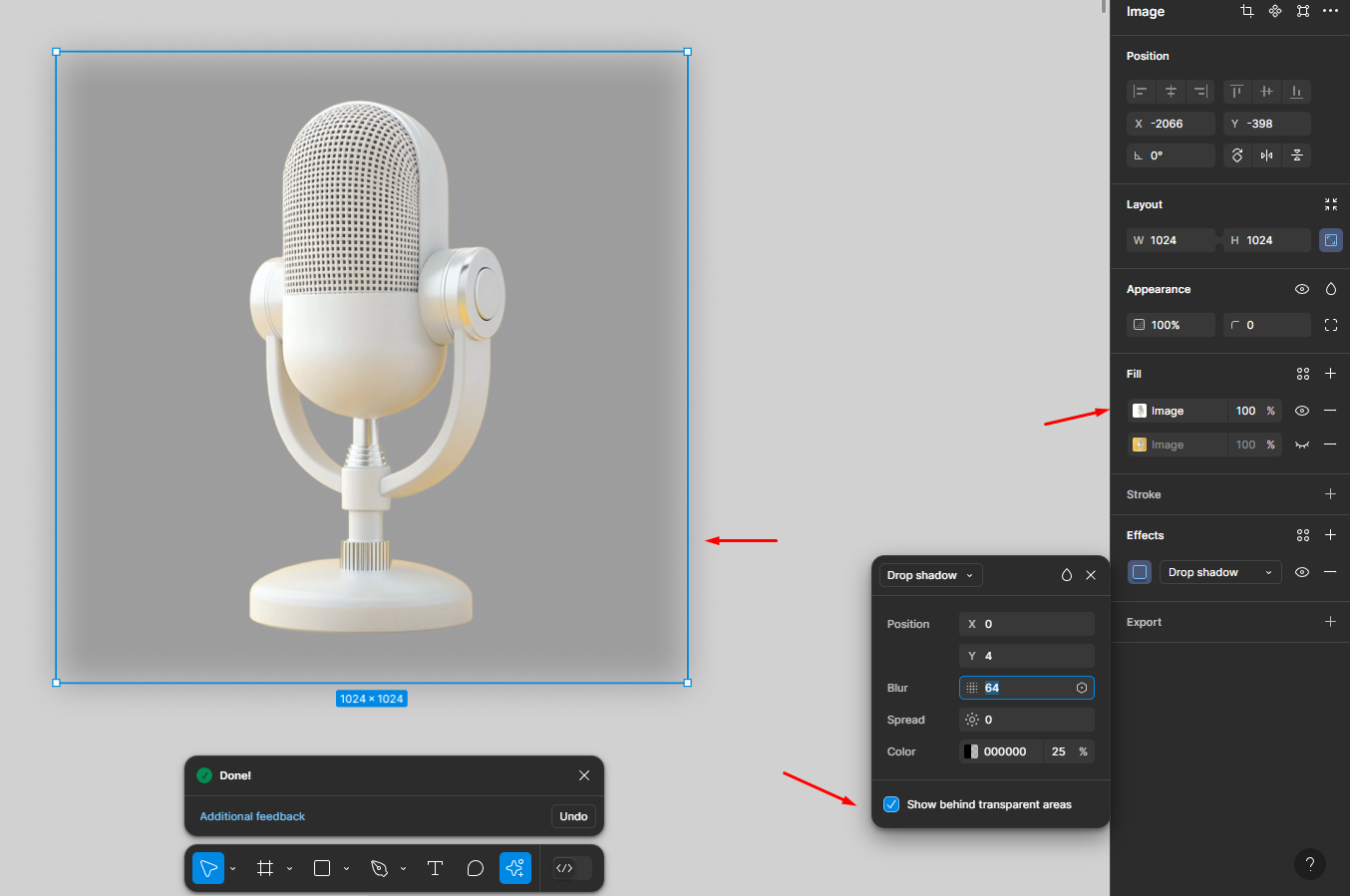

Drop shadow is applied, as if the background was not removed.
It started in Figma slides, I texted support and none of their advices worked.
I asked figma community in telegram chats, also no idea except “show behind transparent areas” but it also did not worked.
Is it supposed to work like this or what? Before I never had this issue for months… But now instantly… IT IS SO ANNOYING :(

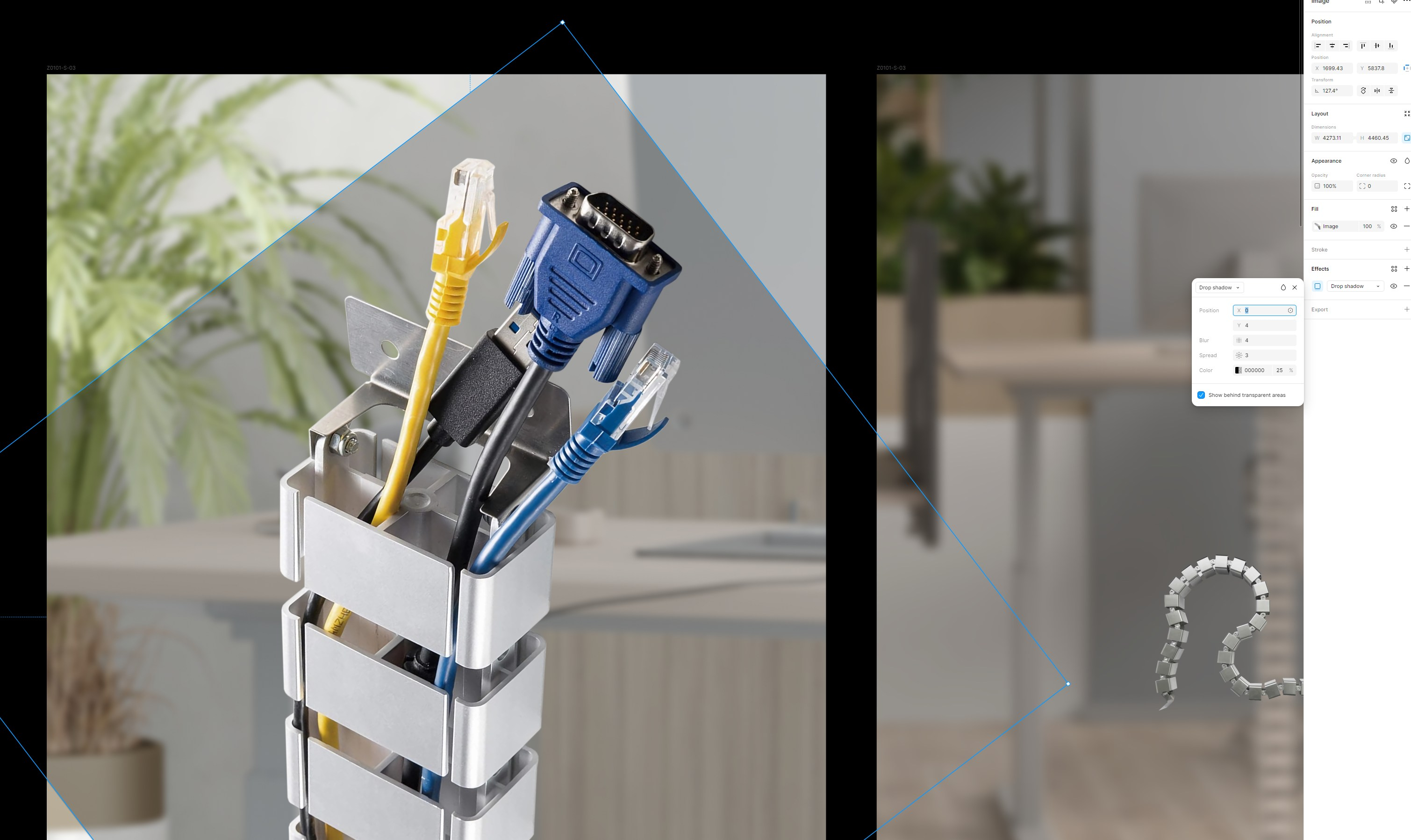

Hey everyone,
Thanks so much for bringing this to our attention! I understand how frustrating this can be. Our team has raised this issue with our engineering department for further investigation.
While we don’t have a specific timeline for a fix yet, we’ll be sure to get back in touch with you as soon as we have an update.
In the meantime, there are two workarounds tested by one of our user that could help as a temporary solution.
  • First workaround:
  1. After using the AI background removal tool, select the resulting transparent image.
  2. Copy the image as a PNG, using Cmd + Shift + C (Mac) or Ctrl + Shift + C (Windows).
  3. Then, paste it back into your design.
This should allow any drop shadow effects to apply properly to the cut-out image itself, rather than its bounding box.
  • Second workaround:
    Remove the original image and then refresh the page
I understand that this is not an ideal solution but please rest assured, we’re actively working to improve the platform and address issues like this.
Thank you for your patience and understanding as we work to enhance the experience for everyone!

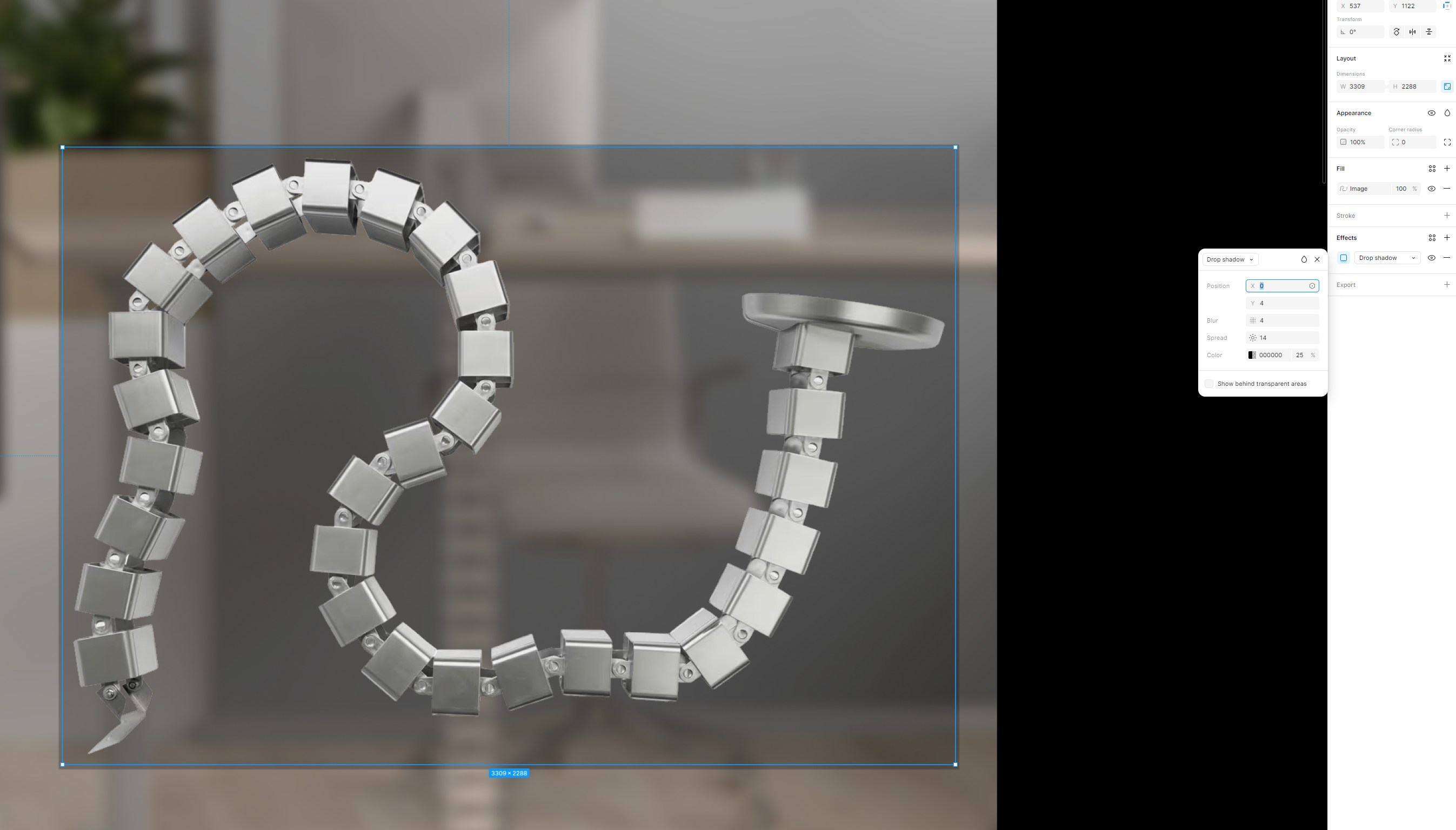

I have this exact issue, I need support on this!!! ASAP

i have the same problem! windows figma app 125.2.3
