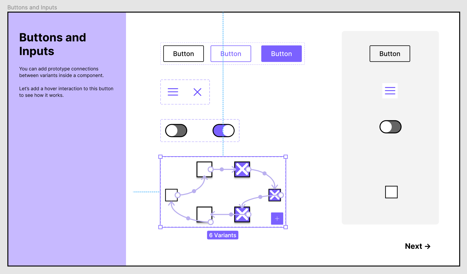

Check this file. https://www.figma.com/community/file/946809607056414616
Look this checkbox, it is getting big when you mouse down, and getting small when mouse up.
