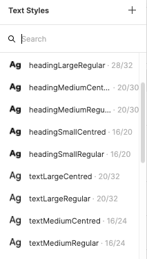

  • I’ve added in a variety of text styles with names in my Figma file.

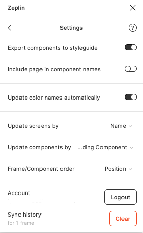

  • Here are the Figma to Zeplin export settings.

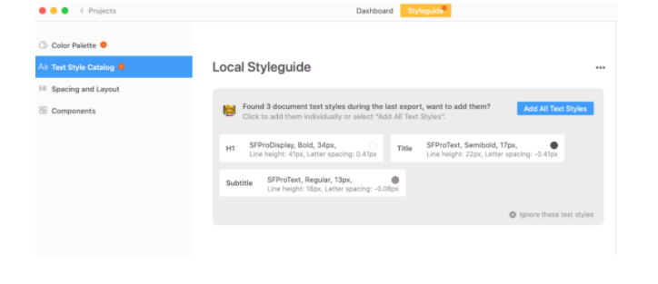

  • When I export new screens to Zeplin, I can’t see any red dot indicating that new screens/text styles/colours have been added. See screenshot below as an example:

Aviv_Meidan
You can make Zeplin suggest the styles again by clearing the cache and the sync history of the plugin (The red buttons at the bottom of the plugin window)
