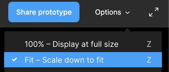

If the concern is that the top bar covers your proto, you should be able to fix this with the Scale Down To Fit option:

That doesn’t work if you have a long page. it will scale down everything.

Agreed there doesn’t seem to be a good answer to this. Scaling down to fit doesn’t work for a long page and hiding the UI isn’t great either if you want to swap between prototypes. The simple solution to this is to have the great team at Figma auto bump down the visual to accommodate the top bar not overlap. This would be huge as I am currently adding in padding to all my frames to hack this.
