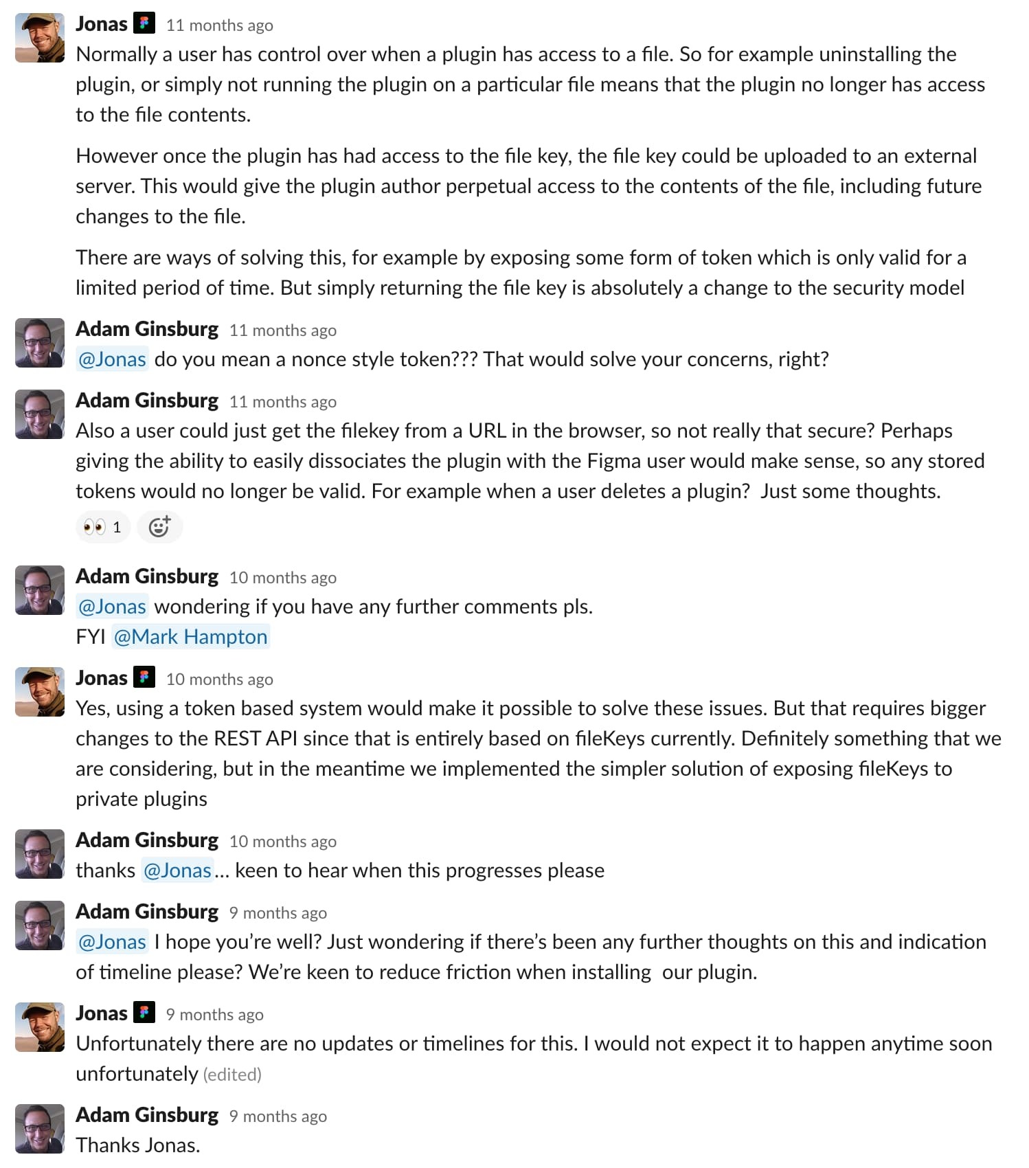

Here are the answers from slack:
Michael_Gubik
Thanks, the reason Jonas gives is what I had feared. This is quite limiting though. Without changing the current API, Figma could just display an alert saying: “Sharing the file key with this plugin will give the developer perpetual access to this file. [ Share ] [ Deny ]”
How can I get a rendering of a frame without the file key?
Also there should be some explanation in the docs for fileKey.
Adam_Ginsburg
@Michael_Gubik we had to do a “dance” and get the user to enter the filekey to have a published plugin - you can see it working in our plugin Buzzy - No Code App Builder | Figma Community
