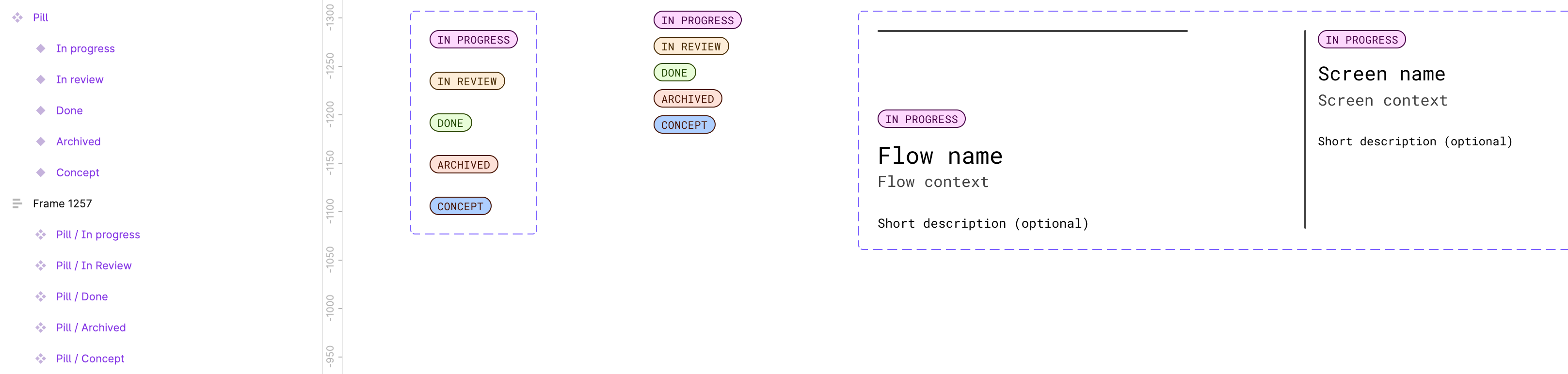

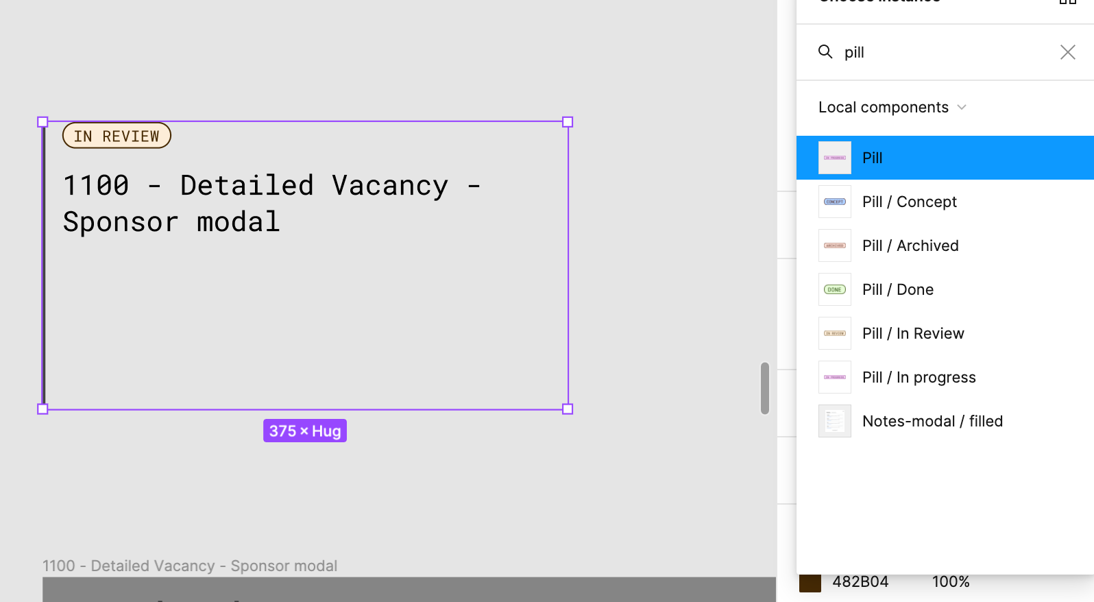

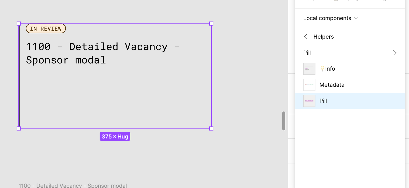

Paul_Brouwer
I just experienced the same problem; having a component set with variants just doesn’t let me switch it on parent level component…
How the heck didn’t they see this coming?

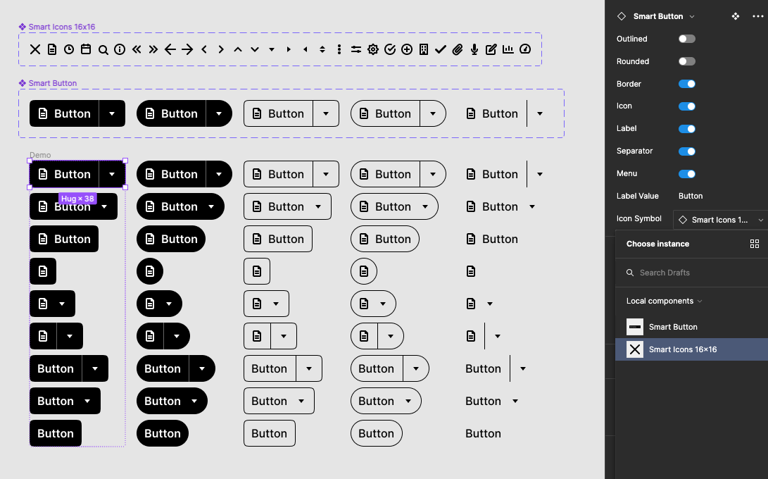

Yuri
  • 3 replies
  • June 13, 2022
I have the same pain of not being able to select a Variant as an instance instead of a separate component.
My screenshot is a simplified example of the situation. The whole project uses a large library of icons, assembled by a set of variants. I don’t want to break it down into separate components to get the flexibility of working with icons through an instance swap. But I like the Instance swap function at all, if only there was a way to choose a Variant…

+1 It would make so much more sense to be able to swap variants in the property panel instead of having to revert back to creating multiple components 🙏
I’m also wondering if it would be possible to swap instances without having to publish the component you’re swapping. In the example @Paul_Brouwer posted above, ideally I wouldn’t want the status component to be published but I would want users to be able to switch the status of the component nonetheless. Dunno if that makes a lot of sense ^^’
Now with the instance swap property, you have to publish all the components that you use for the swap and since we can’t use variants for it, we’re back to publishing more components rather than less…
Paul_Brouwer
Not having to publish components makes sense, but I think it limits your sources of truth. If you have many different variants, including this pill, that need to be changed, then you must manually change them everywhere.
Maite_Who
  • New Participant
  • 12 replies
  • July 6, 2022
ah but they would still be linked to the original component in the library, so if you update the pill in the library then it updates everywhere… but yeah then it needs to be published and not hidden… arh always the struggle to keep it light but useful, but low maintenance ^^’
