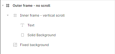

Here’s the setup needed to achieve the chosecommune design:
The fixed background is a child of the outer frame, with the inner frame above it. The inner frame is the same size as the outer frame, positioned right on top of it. The inner frame must not have a fill-color. The solid background is the background that covers the fixed background in the outer frame.
