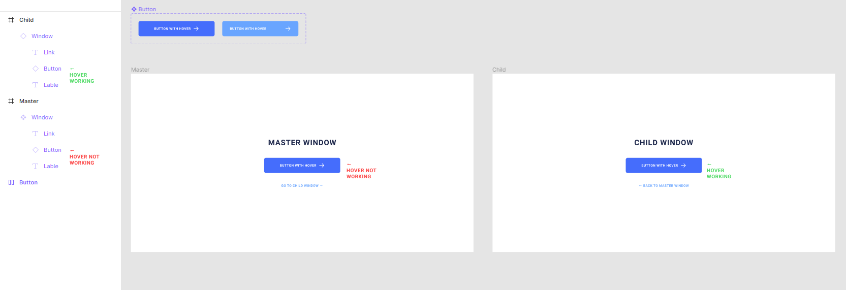

Jaco3
  • August 13, 2021
Hi, I am having sort of the same issue. I created a interactive dropdown and when used inside a master component, only a part of the interactions are working.

I am also encountering a similar issue.
I have a component containing two variants of a set of fields. Each variant shows fields based on the selection in a simple radio button.
I’ve set up the interactive components so that they change between the variants based on which radio button is selected.
If I grab this variant as an instance and use it directly (no other frame around the instance) the interactions work fine.
The second i embed this instance into another component, or even if I just convert the instance into its own master component, the interactions stop working completely. This applies to both local components and also ones i am pulling in from our main design system library (e.g. button hover states)
It seems to have started happening since the update was made to make interactive components work with Auto Layout. It was working fine 3 days ago, now it’s very much broken
I’ve attached a video (sorry no sound) to demonstrate what’s happening here:
cc @Gleb @Andrew_Chan

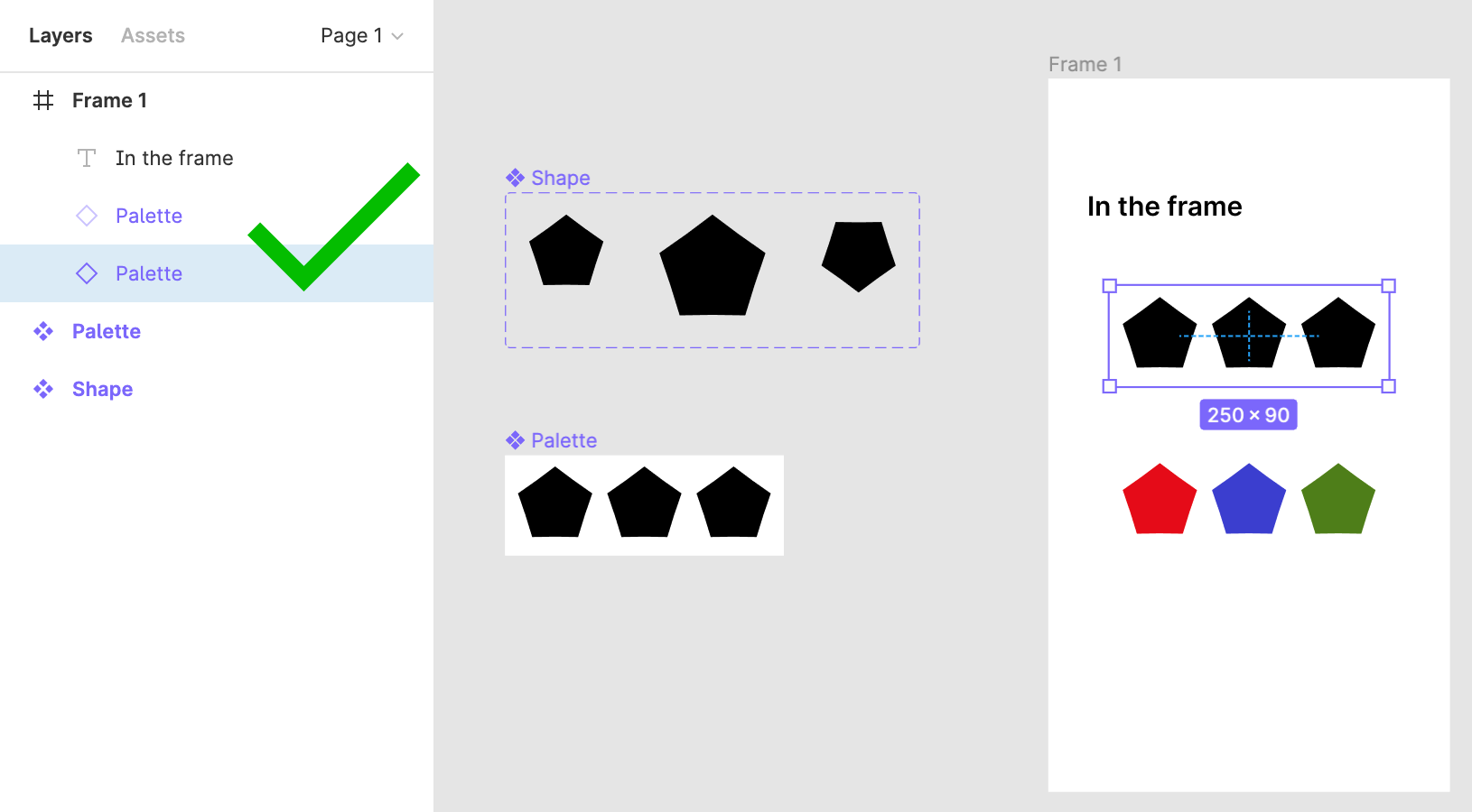

Gleb
  • Power Member
  • 4707 replies
  • October 2, 2021
Does that also not work if you embed the new component instance into a frame? “Bare” components and instances are not really supposed to be a part of the prototype, only instances nested in frames are.

Gleb
  • Power Member
  • 4707 replies
  • October 3, 2021

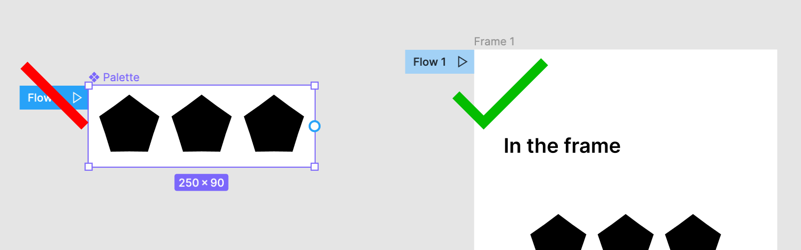

I think you misunderstood what I was saying. You don’t need to detach anything or remove AL. I meant that you need to:
  1. Not use the main component as a part of the prototype. In your first example you added the flow starting point to the main component — this is not supposed to be done (I think this can even be considered a bug, it’s not supposed to work).
  2. Only use instances wrapped in the top-level frames. Create a frame, then add a component instance inside. Again, not the main component, but its instance — main components are not supposed to be used in the prototype.
Example prototype with nested components where everything seems to be working fine: https://figma.fun/aAivsk

Gleb
  • Power Member
  • 4707 replies
  • October 12, 2021
That’s just my understanding. Main components have a special behavior in the prototype: the actions you add to the main component would propagate to instances. So my mental model is that it’s a template, and using the template with instances doesn’t make much sense. Also in the video above the user manually added the flow starting point to the main component because it wasn’t added automatically — it’s like Figma tries to resist users setting main components as a part of the prototype. And I think this makes sense.
