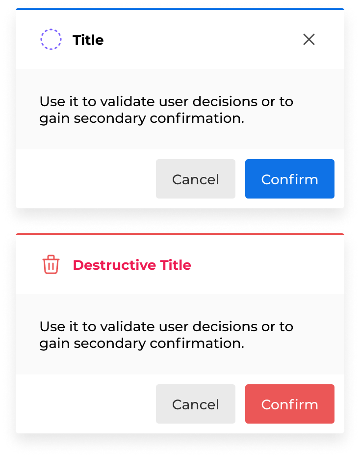

Is this not what you speak of?
If not, can you share a file?
