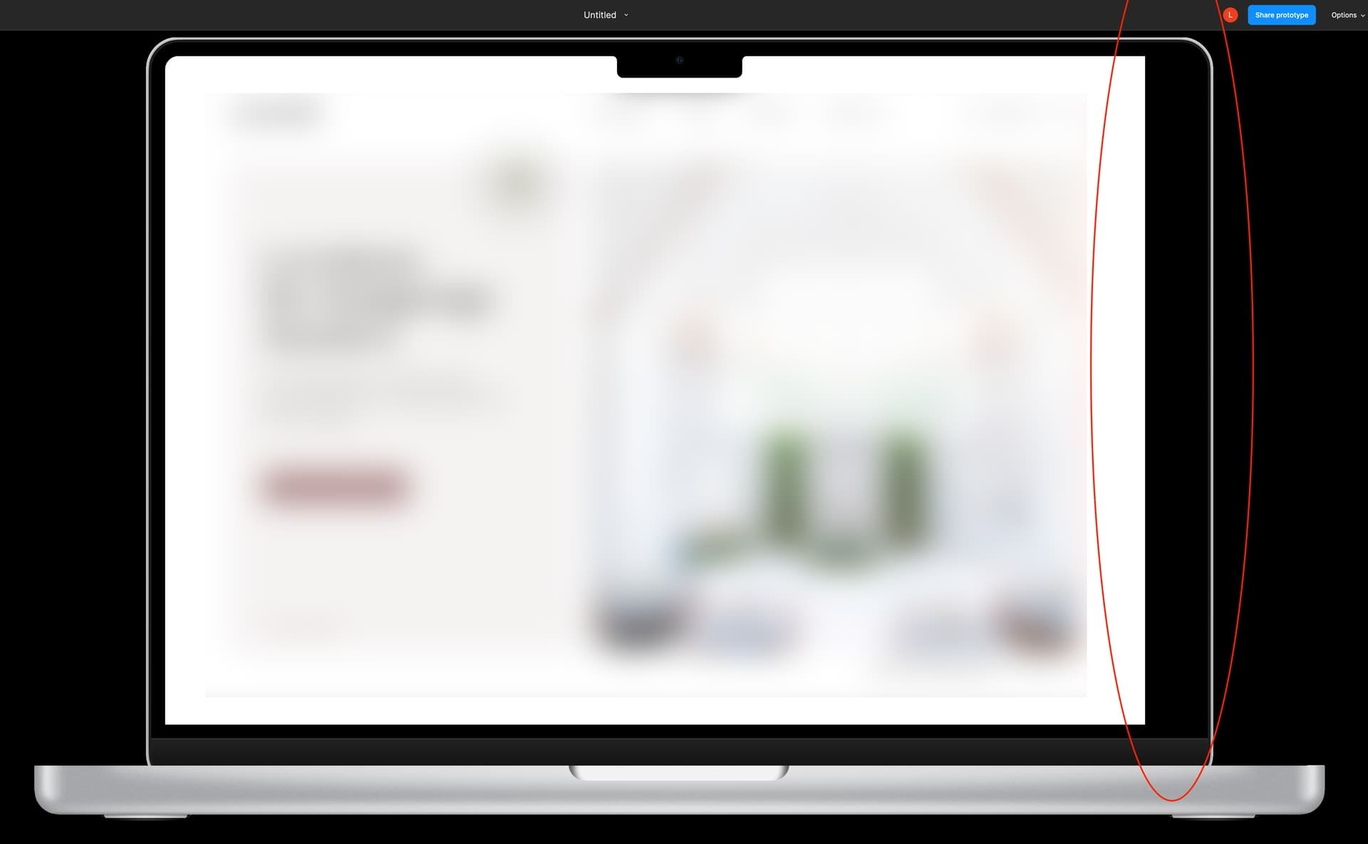

Hey everybody. So since yesterday i have the problem, that my screens are not scaled up in prototype mode anymore. My screens are 1440px and i want it to fit into the macbook 14".
But now it doesnt work anymore. I already tried with the Interface scale and the options in prototype mode. That doesnt work as well. Please help!

Hi @Laira996 I found the solution for this issue , you just have to resize your screens to fit into mac 14 to (1512 X 982) and you will be set 🙂
