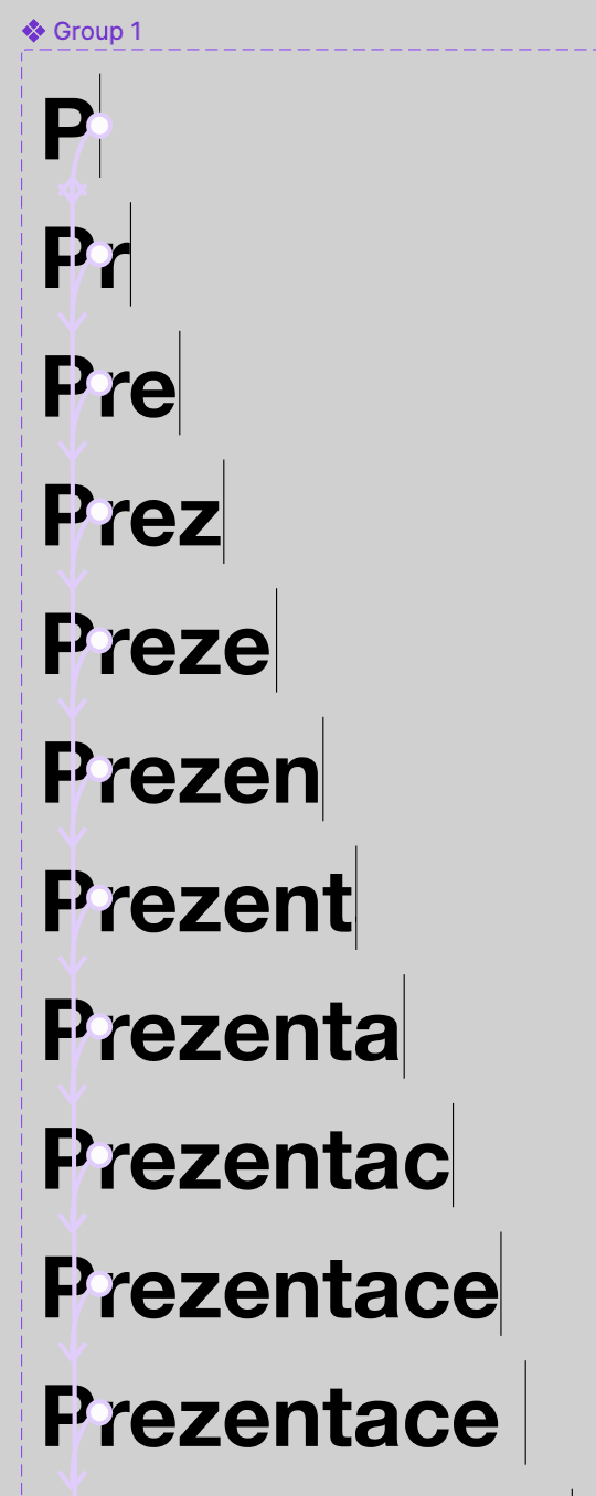

Hello, I am very new to Figma API and javascript, this is my first plugin, so while this might be obvious to you, its not for me, so I would really appreciate your help.
Im trying to do text typing animation plugin. See what I mean
I decides to use interactive components. It will generate different “frames” of the animation and than it will connect them all through interactions to create a seamless video (obviously not real video, its in figma)
I think I got very close, but not close enough, it still throws an error: TypeError: ‘0’ is read-only
