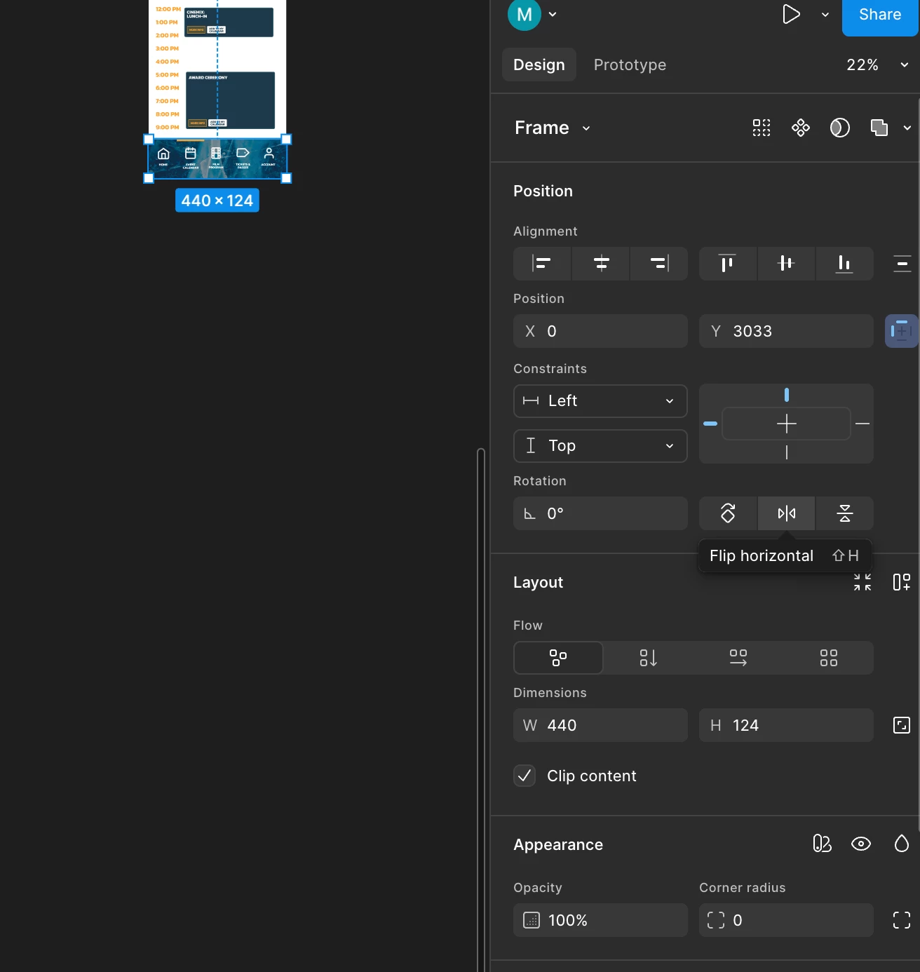

Where is absolute position option is there in Figma in latest version? is the name changed as “ignore auto layout”?
Best answer by djv
Hey @Ambalika_guha, sorry for the confusion!
Yes - absolute position is now Ignore auto layout in UI3.
