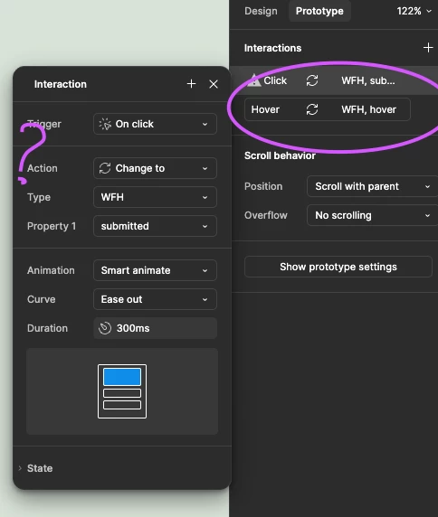

September 14, 2021
  1. When a wire together a button that ‘Changes To’ a the button with a hover state, the click interaction has to be on the hover state button, not the original button. This is confusing to me and cumbersome as all of the original logic of click interactions I now have to transfer to the hover state

I’m experiencing the same bug as a result of a button component changing to Hover then Pressed. My ‘on click’ navigation interaction is not navigating. Is there a fix for this yet? Should I just remove the ‘pressed’ state?
