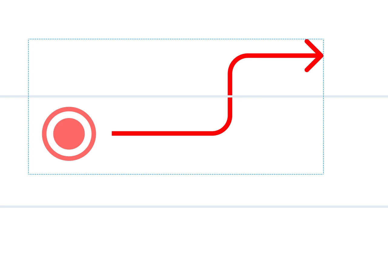

Note: double clicking twice is a way to select a whole component/frame/group at the highest level and it works reasonably well already, but things get tricky when that element is not in front, e.g. in the screenshot attached, the elements in red are part of a group, but because that group sits below some rectangular shape with no fill, selecting it on double click is utterly impossible.

As I can’t edit the previous reply, I just want to add that the current functionality does indeed allow to select at a higher layer than the deepest, when in ‘cmd sometimes it doesn’t work as expected (e.g., it doesn’t allow me to select a frame/group if it’s positioned on top of other layers, in a situation similar to the one described above, in the screenshot).
