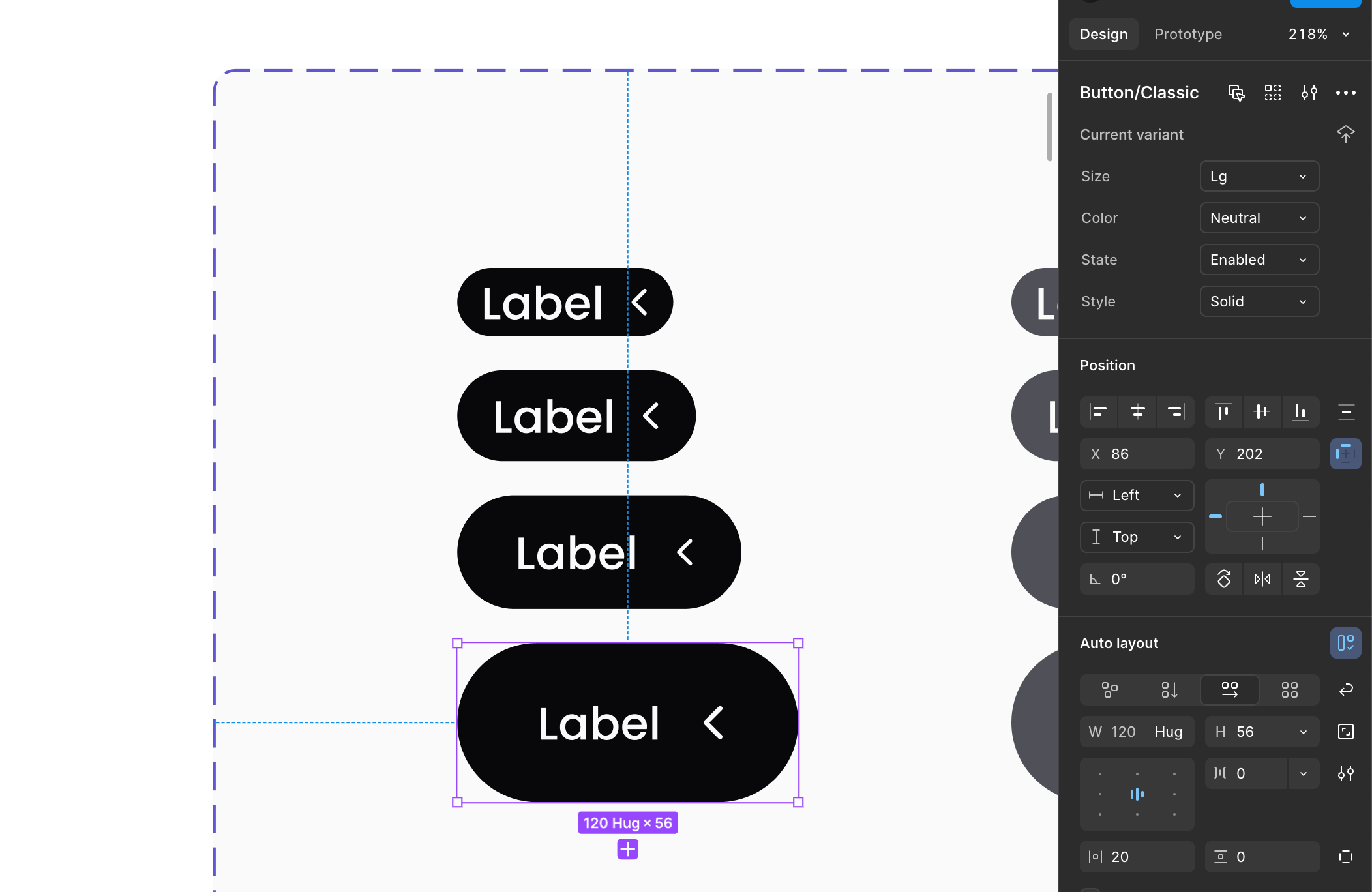

  • I changed the height of my “lg” buttons from 48px to 56px
  • I also changed the radius from 16 to 24px
  • I published my library and updated it on me design file
What is happening:

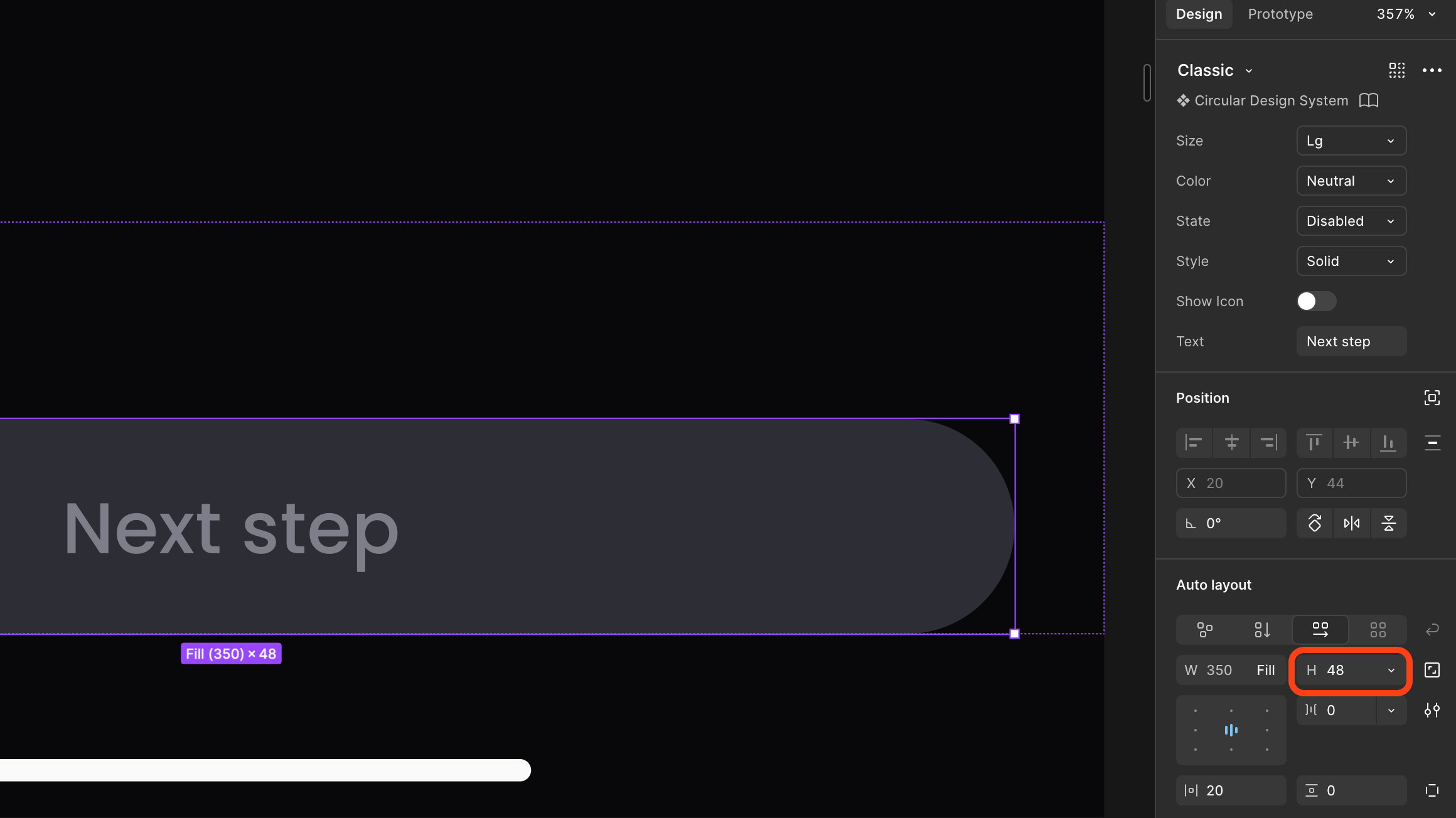

  • The radius updated on all buttons
  • The height of the buttons did not change
I’m wondering if I did something wrong or if this is a known bug?

Hey ​@Quentin_Saubadu, thanks for flagging this and laying out the steps so clearly. It looks like you’ve done everything correctly. I see what you mean about the resizing behavior in the screenshots you’ve provided.
I tested this on some ‘call to action’ buttons in a library in one of my files using the Figma Desktop App (version 125.4.9) — very similar in style to what you have with auto layout added, and the height and radius updates worked as expected on my end. Are you still seeing the issue?

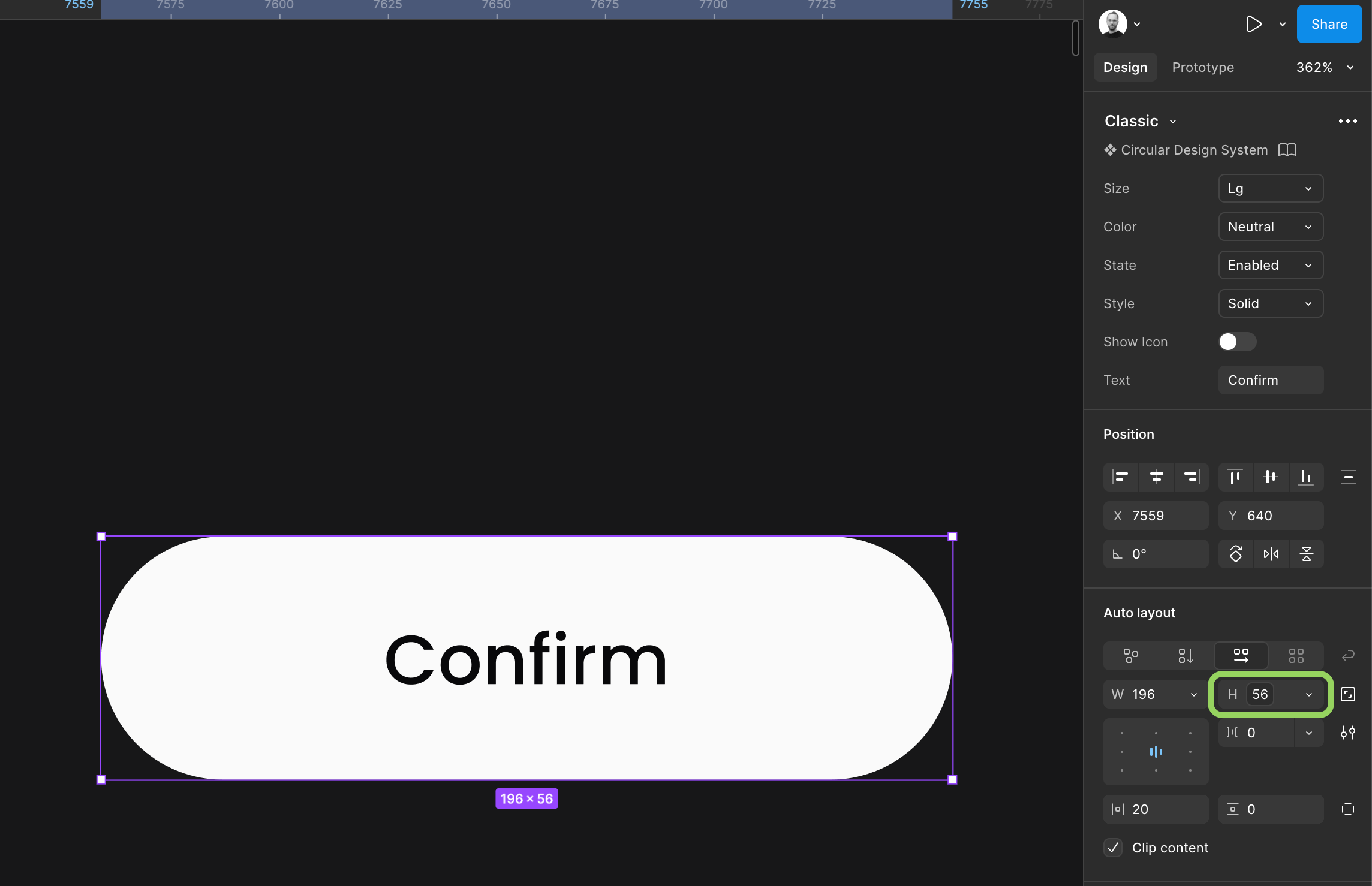

I managed to “fix” the problem by creating a height variable in my system and applying it to the button. I shouldn’t have to do that tho, I’m wondering what’s happening.
I’m on the desktop App, my version was updated (I verified before sending the message). Now my app is updated from yesterday but the bug is still here.
Also there is no overrides on this instance, I double checked.
