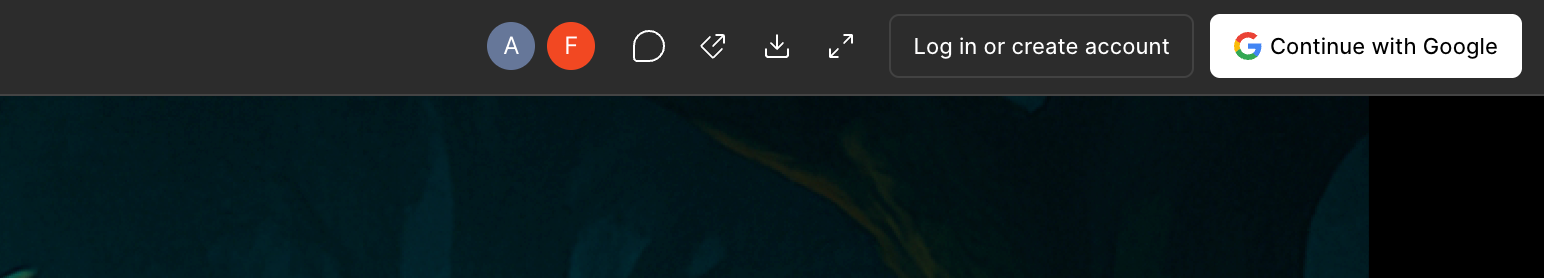

Sharing an ‘Audience link’ gives the recipient a view-only view of the slides. However, it also allows them – who will very often be a client – to click a button at the top to open a view-only version of the Figma file along with all of the presentation notes.
Unfortunately, it’s currently not fit for purpose to share a link with clients, as there’s no way to send it purely for viewing without all the additional UI options to open in Figma and view notes etc.}
Ideally, there needs to be a sharable ‘Audience’ view of the slides where all that can be seen is the slides – no extras, no ‘sign in’, no ‘add comments’ (ideally this can be switched on OR off), and definitely no ‘open in Figma Slides’. Just a view of the slides, and that’s it.

For anyone else wanting a quick fix to remove all the UI and just show the slides, I added this to the end of the url before I shared it with the client:
&hide-ui=1
Not ideal, as it can just be changed by a viewer and they can still open it in Figma and/or leave comments, but fixes it for now.

I was at first excited to build a prezi staying in my favorite design tool Figma—and then really frustrated when realizing (after investing in creating 60 content rich pixel perfect slides) — that I can’t SHARE the slides without giving them access to controls and my original file.
Also when sharing a link, my clients were required to go through a Figma sign-in/sign-up process: this is a barrier to clients opening the prezi, period.
Q: Do you know, is there a way to share Figma slides that doesn’t require the audience to go through a sign in process before opening the slides?

Simply hitting the ESC key brings back the UI :/
@figma please fix this issue so we can use Slide for client presentations.

Give me the ability to remove the UI, especially the ability for the recipient to open the deck in Figma slides.

It’s not fixed. Anyone with the link can open the presentation in an unlogged in version of Figma slides and see the presenter notes.
Corinne Sherry
Good clarification! My need is met in that I can now send an audience link and embed a presentation without the thumbnails showing. (Also on mobile I don’t think you can get to that UI to login.) But if you want to completely prevent accessing the slides view then you’re right more work is needed!
