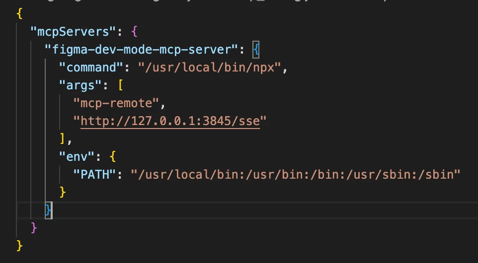

only http://127.0.0.1:3845/sse works. http://127.0.0.1:3845/mcp still returns
{"jsonrpc":"2.0","error":{"code":-32001,"message":"Invalid sessionId"},"id":null}
(Figma Desktop App version 125.6.5)
