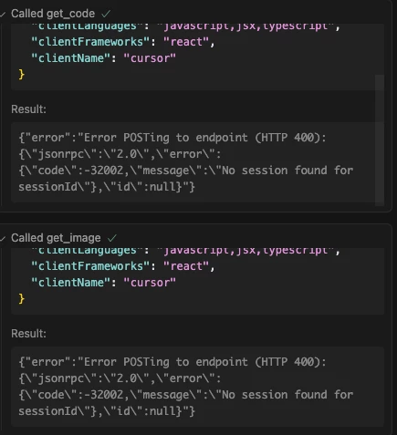

Anyone had any luck here? I get stuck in calling_get_code:
"clientLanguages": "typescript,javascript,html,css",
"clientFrameworks": "react,next.js",
"nodeId": ""
Visiting the URL gives me: {"jsonrpc":"2.0","error":{"code":-32001,"message":"Invalid sessionId"},"id":null}

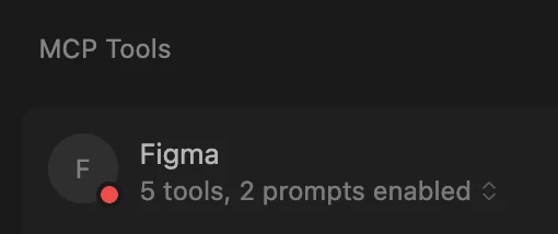

I also don’t understand why the indicator keeps going red no matter home many times i turn it off and on.

            - INFO - Calling endpoint: get_code, with args: {'clientLanguages': 'xml', 'clientFrameworks': 'android'}
            - INFO - Unexpected error calling get_code
            - "POST /get_code HTTP/1.1" 500 Internal Server Error
Please help to check it, thanks~

@Tom Reem
  1. Only http://127.0.0.1:3845/sse can access, http://127.0.0.1:3845/mcp still can’t access.
  2. Although http://127.0.0.1:3845/sse's OPTIONS, GET responds normally, tools such as get_code report errors. error code: 500
           - "OPTIONS /openapi.json HTTP/1.1" 200 OK
            - "GET /openapi.json HTTP/1.1" 200 OK
