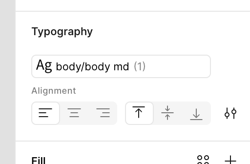

Thank you for this. I was having the same issue as ​@Johannes_Eckert  (link to post) and fixed it with these instructions.
There were some text elements inside my master component which had overridden text styles. This happened because I applied a body text style to them and then added an underline to make them look like a link, causing the text style to be overridden. This meant that every component instance would lose its properties whenever its variant was controlled by a text variable, because the master component had overridden text styles.
I went through each text element in the master component and unlinked the ones which had a the little (1) in brackets after the style name:
Changing the variant with a text variable now works just fine.
I would never have guessed this was causing the issue, so I’m glad this was explained.
