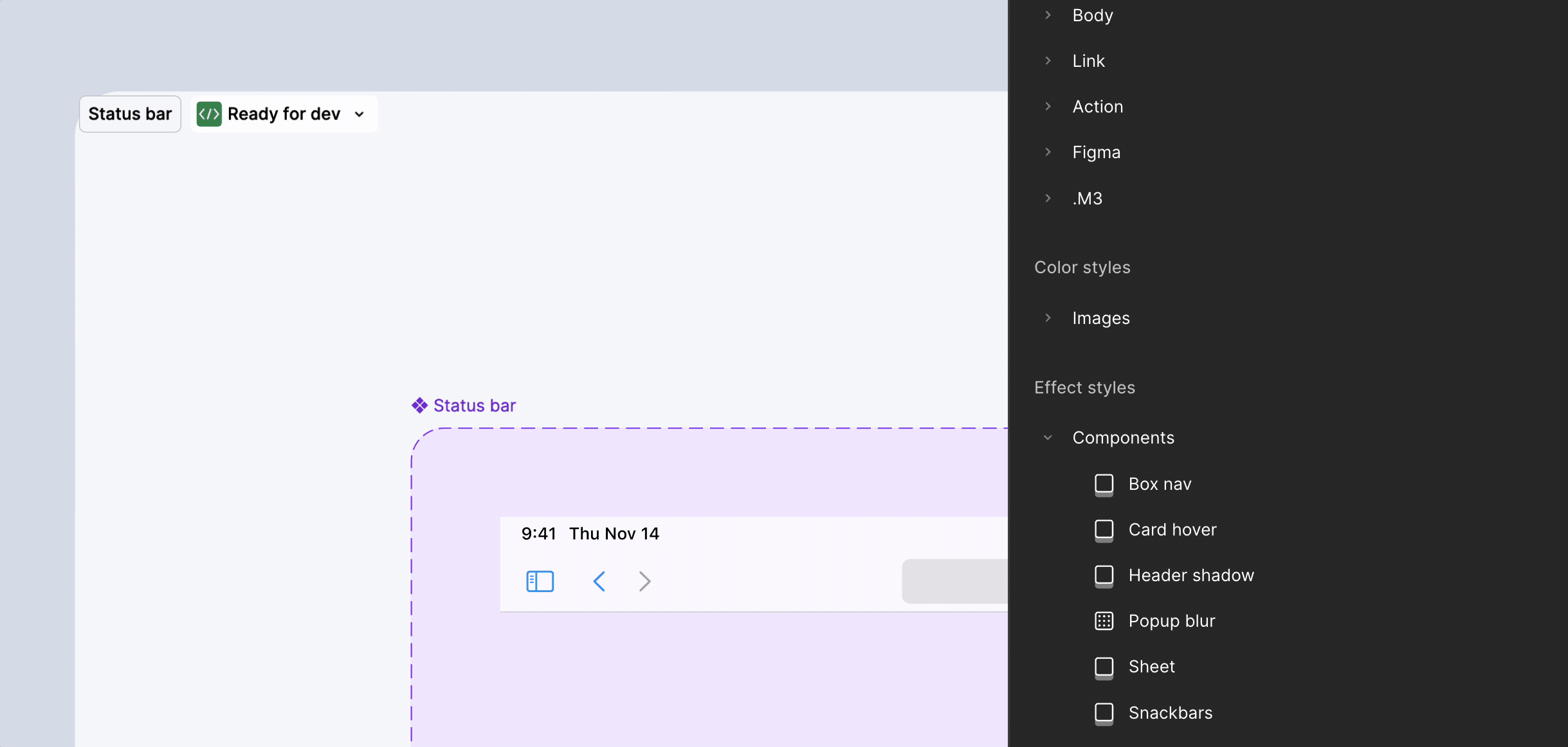

Bug: Change width from variable to fill, changes back to variable after section mode switch
What happens
  1. I have a Frame inside a Component, the Frame width is set to a variable (with some Modes).
  2. Now I change it to be filled.
  3. I change the section Mode.
  4. I change the section Mode back again.
  5. Now the Frame in the Component is set to the variable again, instead of fill.
Expected behavior
When I change width from a variable to a fill it should not change, regardless of me changing the Mode of the Section.
Work around
  1. Select the frame.
  2. Change the width from a variable to a pixels first – this will disconnect the variable for real.
  3. Now change the width to fill.
  4. Done!
