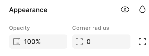

Good afternoon. The paid version of Figma was paid for. Appearance now has the option to select a color, but there is no color list in the Variables list. Why aren't the colors displayed in Appearance?

If I'm understanding correctly, are you trying to apply a color variable to a setting within the Appearance section of the right sidebar?
If that's the case, please note that color variables can be applied to solid fills, gradient stops, stroke colors, and color styles. For Opacity and Corner Radius, you'll want to use number variables instead.
For more details on how to apply variables to your designs, please check out this helpful guide: Apply variables to designs
