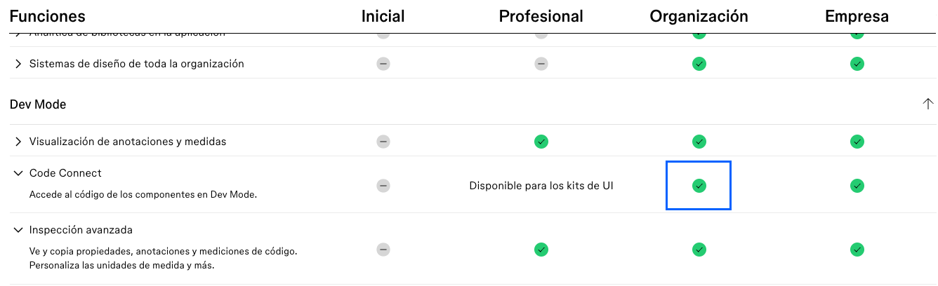

I am trying to get variables from my library, just that. Because Code Connect is available for Organizations and Enterprise plans, I want to use Code Connect, since I am a member of a Organization.

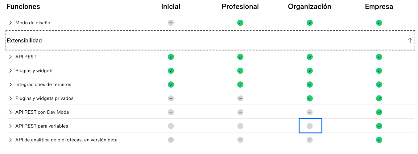

Someone told my in another post, that is related to this one, that I will not be able to get the variables, unless I am a member from a Enterprise account. I think she is right. Can somebodey confirm this?
I don’t think we are getting a Enterprise plan soon. Can somebody recommend me how to get variables without the REST api then? I think a plugin is the only way… any reocmmendations?
