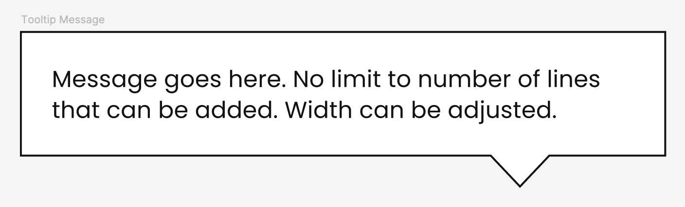

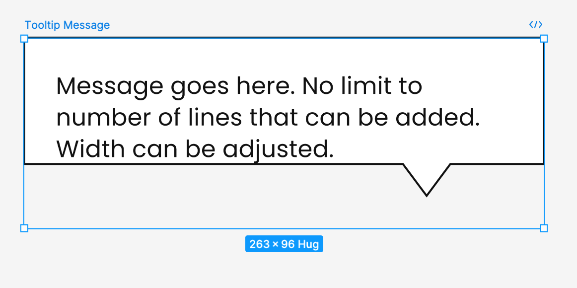

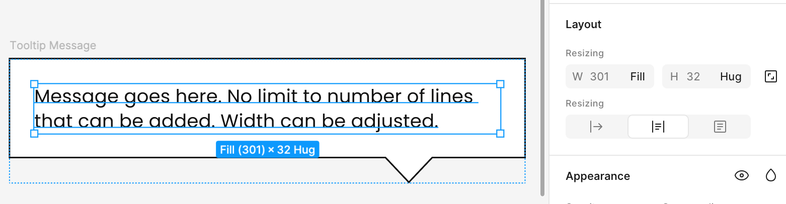

I created this tooltip box (union of a rectangle and triangle). It’s set so that the text width adjusts according to the width of the tooltip box. I also want the size of the box to be adjustable, but am coming across 2 issues:
  • Box height isn’t changing to accommodate the text line number increasing
  • Triangle pointer doesn’t maintain same width
I’m not sure what settings are needed to fix this. This is what I have currently:

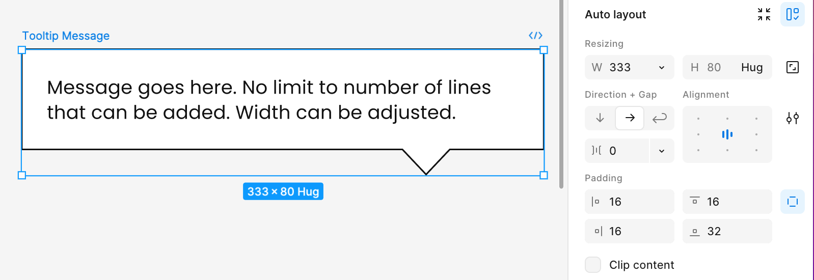

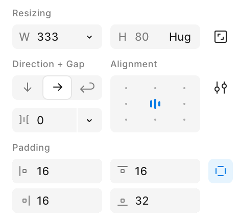

Autolayout of whole component. The text itself is set to fill/hug.

Set the text layer’s height to hug, and also the container of tooltip to hug
Maybe your container is set to hug but the text height is fixed.
Angela Liu
Apr 29, 2025 3:27 PM UTC
​@Raphael_M the text layer height is already set to hug. Same with the height of the autolayout frame.
The union shape is fixed though. Figma isn’t giving me the option to change it to anything else

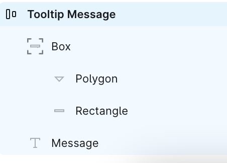

How did you do it? Can you show me your layers?
Angela Liu
Apr 30, 2025 1:46 PM UTC
​@Raphael_M

Hmmm. I don’t think that’s going to be easy since you use a vector for your bg, but I guess it has something to do with the stroke.
That’s because it’s being scaled together with the container.
Your vector’s dimension is fixed.

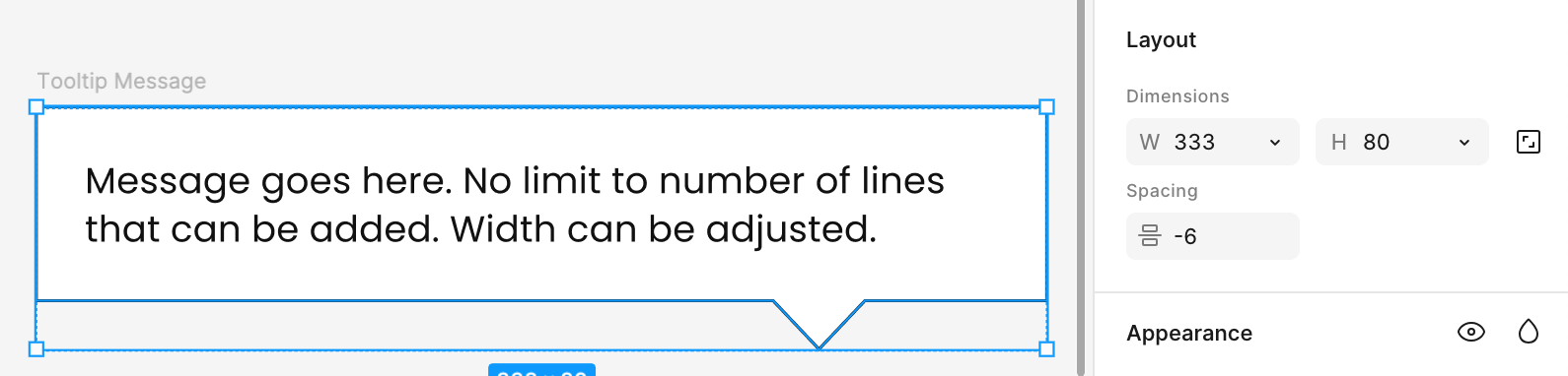

How about trying something like this? (attached)
Angela Liu
May 9, 2025 6:27 PM UTC
​@Raphael_M that worked, thank you! And I figured out a workaround for the stroke too
