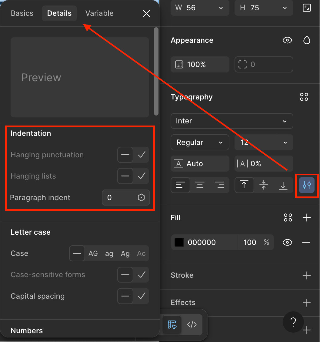

I tried using paragraph indent but I can't find the feature on figma. Has it been removed from type setting?
djv
  • Community Support
  • June 25, 2025
Hi ​@Faith Fola, thanks for reaching out!
You can still apply paragraph indent. From the Typography section of your Design tab, locate the toggle icon to open Type settings. Switch to the Details tab, and you’ll see a section for Indentation.
Hope this helps! Please feel free to reach out if you have any further questions.
