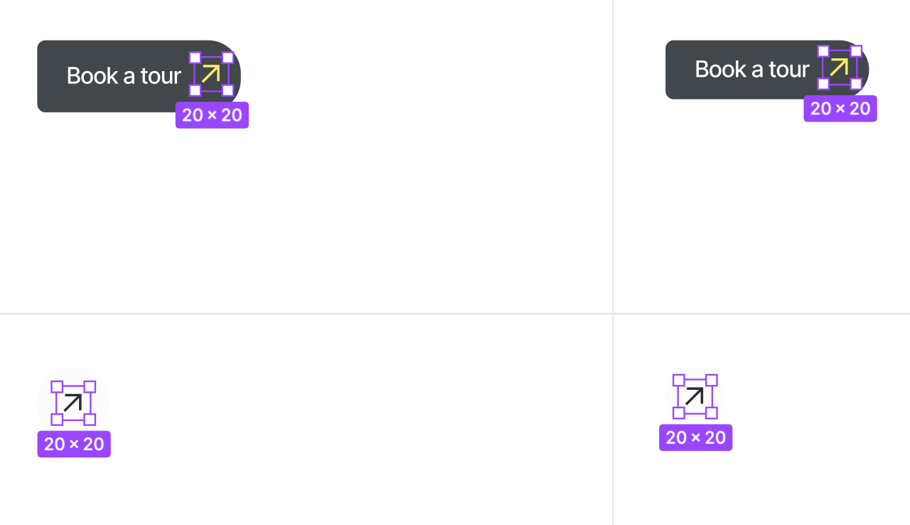

I have the same need. I would like to select a certain component with a specific color variant so I can swap it out for a component a different library.
Currently, the “Select Matching Layers” does not discriminate between the various properties of a component/its instance. See below: I am only wanting to select the instances with a yellow arrow, but it selects all arrows.
