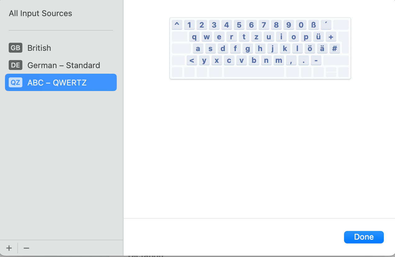

Hey ​@AnastasiaF, thanks so much for the detailed explanation and apologies for the delayed response!
I’ve tried to reproduce the behaviour on my end, but everything seems to be working normally here. I’ve attached a screenshot for reference.
Just to help narrow things down—could you double-check whether your keyboard layout is also set correctly within Figma itself? Sometimes individual apps can have different input settings.

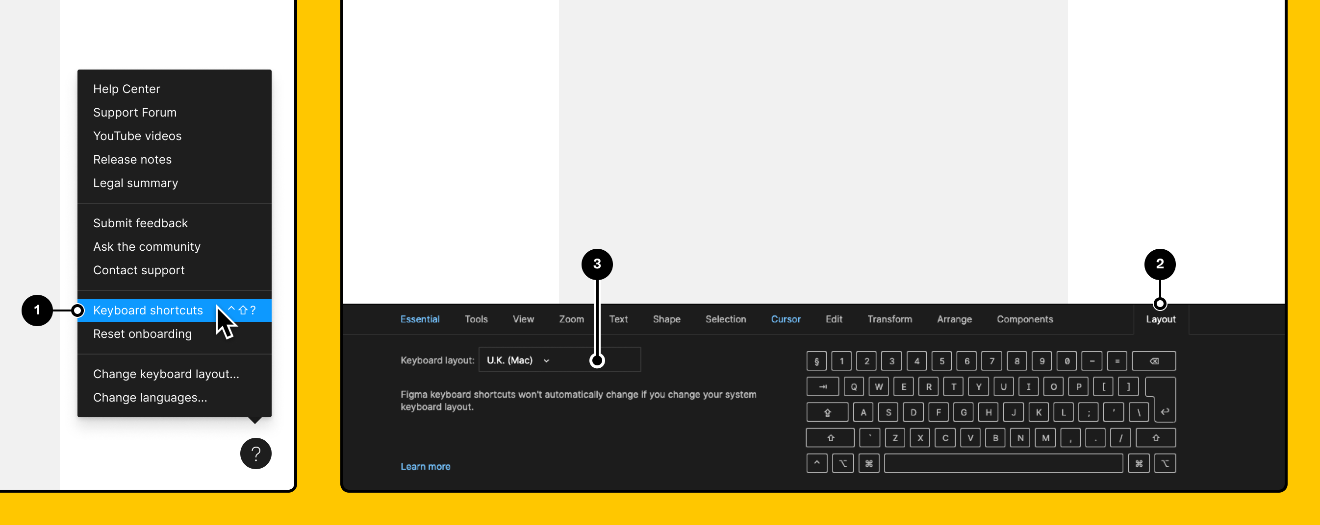

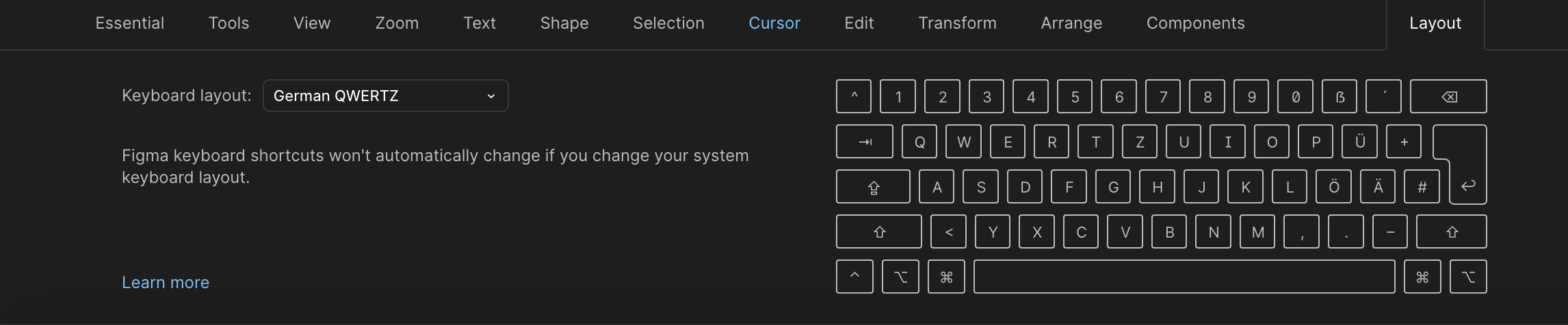

Hey ​@AnastasiaF, thank for the clarification. You’re right that Figma doesn’t automatically adapt to your macOS keyboard layout in the same way. By default, it assumes a US QWERTY layout for shortcuts, which can cause issues like the one you’re seeing. To adjust this within Figma itself you can head to Menu > Preferences > Keyboard layout and switch it from QWERTY to QWERTZ. This should align better with your physical keyboard and hopefully make shortcuts like Command Z behave as expected.
For more information check out this Help Center article: Select keyboard layout
Let me know if that works for you, and if not, I’m more than happy to flag this with our technical team to dig deeper.
