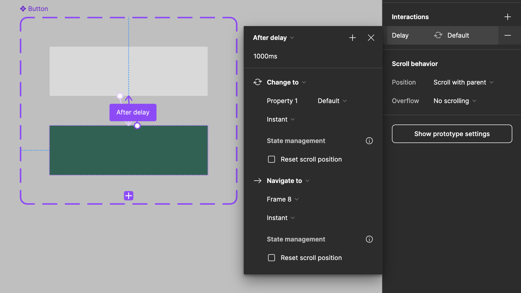

Can a button be created that changes to a pressed state when you press it and then navigate to another frame after a short delay?
I’m developing a mobile app and need my buttons to have a pressed state before navigating to another frame.
I am trying to resemble a real-world app, following the M3 material design guidelines
I tried making a component with both variants of the button (“default” and “pressed”), so when the default is clicked it changes to the “pressed” variant, and the “pressed” variant changes back to the “default” state after a delay. But I can’t figure out how to navigate to another frame while making the button reset its state to the “default” variant

Vishal_Ramawat
June 24, 2024
On Default button variant add On Click > Change To:
On Pressed variant add After Delay > Change to + Navigate To
