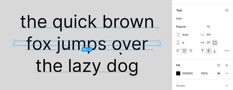

I’m trying to find a way to make sigma adapt the blue box layout around the text automatically in the pic below.
Imgur
When I use the auto layout it still doesn’t work. The result is that the blue bo is not fitting the around the text precisely but leaves some arbitrary space. This happens even when I set the paddings in auto-layout to zero.

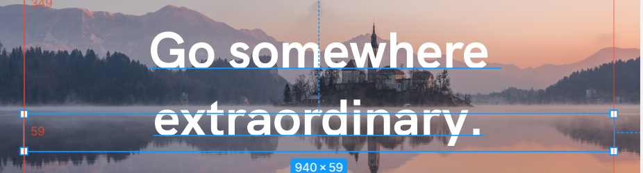

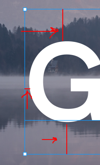

I’m still confused as why It’s leaving some space. Both fit to width and to height leave some space as show in the pic.
Imgur

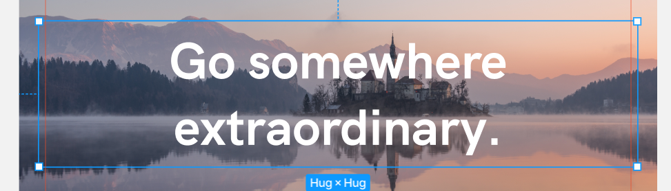

This doesn’t happen for shapes where the blue boundary fits nicely
Imgur
