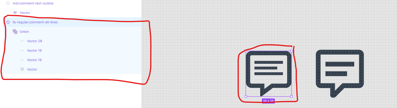

So recently I started having issues with performance in some of my flows. My first thought was that it was somehow related to me over-utilizing the “new” boolean properties and nested layers/components. I spent two days trying to optimize my layering without any significant change, the prototypes were still super laggy.
But today I noticed something. When switching out one of my custom modded icons the lag disappeared.
The modded Icon is encircled in the following picture:
I have no idea if it’s the “unioned” vectors causing the issue or what but changing this encircled icon to the one on the right totally resolved my performance issues.

Update: Flattening the vectors instead of Union also resolves the performance issue.
