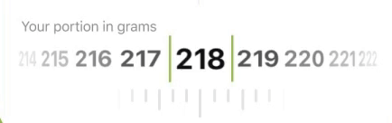

Hello everyone,
Does anyone know how to replicate an animation like the gif attached below in figma?
Thanks

It depends. Are you wanting this to be a full user interaction (so someone could scroll through it freely) or just a thing where they swipe and that triggers a fixed animation (e.g. from 218 to 214)?
For a fully free interaction, you could do everything in that GIF except the radial compression/expansion of the numbers at the ends.

Hello,
I’d prefer the full interaction but i don’t mind the fixed animation either. Do you have a solution for one or both?

I don’t have any perfect solutions, as the compression on the edges is not something easily animated (it would take a lot of work). Here are two solutions. The top is a simple free scroll, but that has the disadvantage of not lining up cleanly to the numbers. Below is more of a fixed animation, which can be done in multiple ways depending on the need. https://www.figma.com/proto/0eBPiQhl8hgNxFkga0nXjs/FF-Animated-Dial?page-id=0%3A1&node-id=10%3A655&viewport=241%2C48%2C0.64&scaling=scale-down
