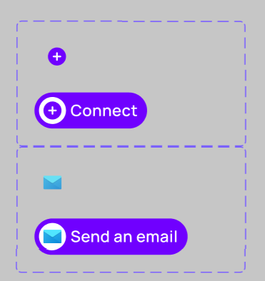

Glen_Lipka
Any update on this? I have a similar situation.
I’ve got buttons like this that are next to one another in a row. When you hover over one, it expands with the text (interactive component variant) AND it should push the one on the right to the side to make room for it. They are in an autolayout.
I have tried this numerous ways and I think the problem is this idea.

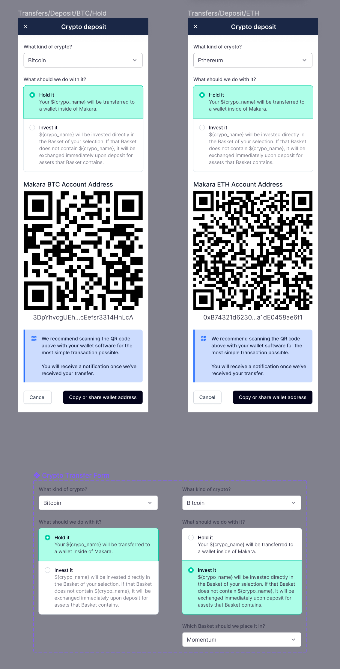

This is one of the first issues I’ve encountered in the Beta, and it feels fairly crucial. Was the initial design just meant to handle variants that are always the exact same size? (…and not accommodate for text changes in components?)
I’m ecstatic to know this feature is being proactively worked upon!
In a prototype, I want to:
  1. Click a text line that says: “Advanced Options”.
  2. Once clicked, I want a form to appear below the line (expanding).
  3. Existing page content that would overlap with the form should move down in order to accommodate the form’s size.
  4. The page length should expand down to fit the page’s content including the newly added form.
  5. When I click on “Advanced Options” again, I want the form to disappear (collapse) back to its original state.
