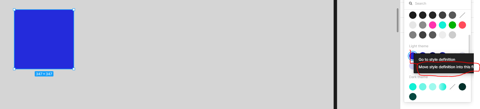

I am working with my colleagues on a new design system. We have given view to our design system library to other designers who use the DS in their own projects. However, even though they only have view on the DS, they can make changes to the library by right-clicking on the color palette, and click “move style definition into this file”.
Does anyone know if there is an option to disable this?

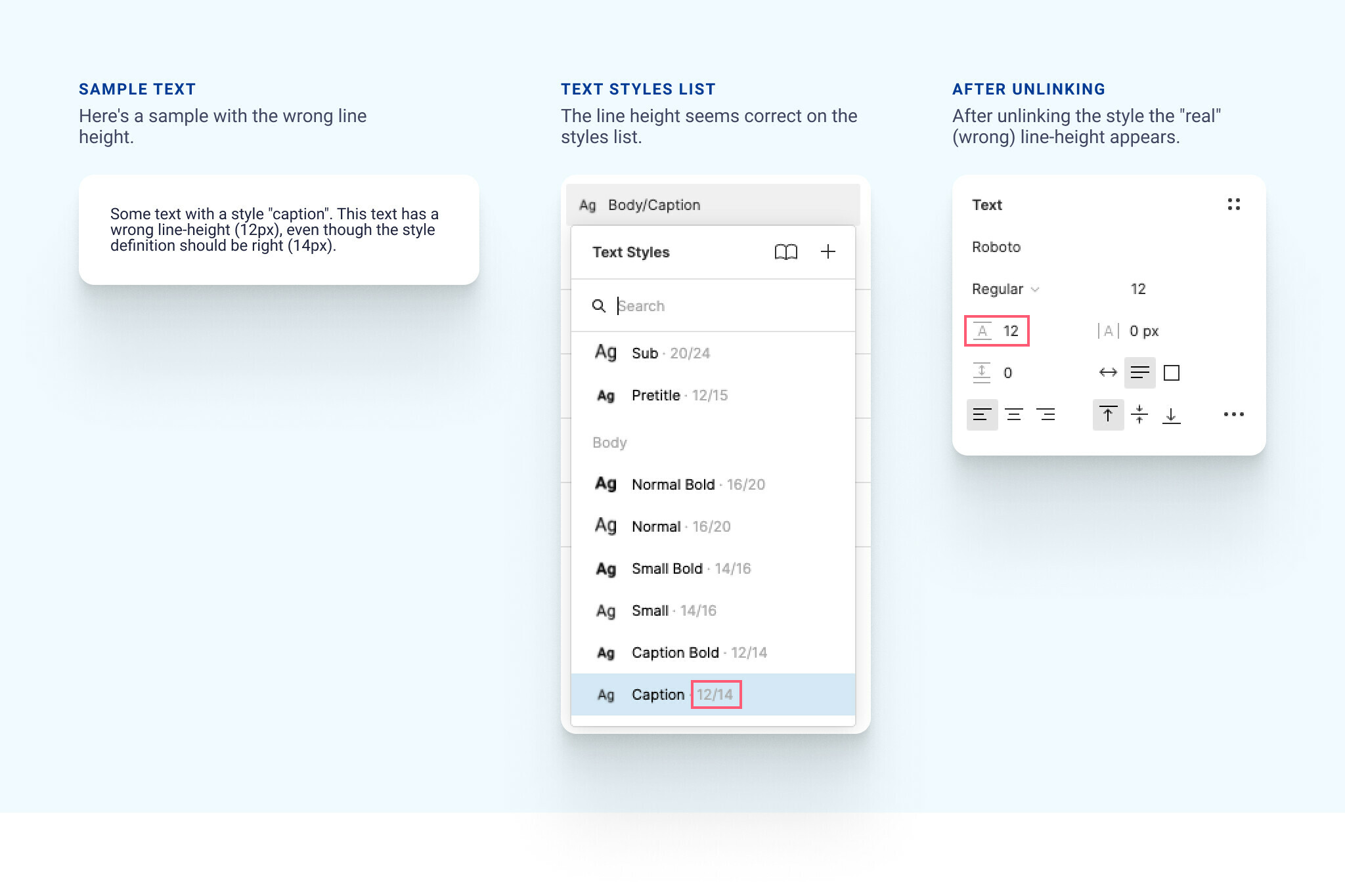

This happened to me as well, and I managed to reverse the action.
What happened
I use a text style called “caption” from a separate design library file. On a working file (with over 30 pages) I accidentally clicked the “Move style definition into this file” and immediately hit CMD + Z to undo the action. As a result, the style was gone from my working file.
What fixed it (edit: almost)
On the design system file the “caption” style had two options:
  1. View the style in the working file (“Go to style definition to edit”) where the style had been moved.
  2. Move the style back to the design library file (“Move style definition into this file”).
Clicking the second option moved the style from the working file back to the design library. It also seemed to fix the unlinked content from the working file, and now everything seems to be as it was before.
Edit: Now when I update the style in the design library, the changes aren’t reflected in the working file anymore. Weirdly enough, the change I made (line-height bump from 12 to 14px) can be seen in the list of styles, but when unlinking the style, the “real” (wrong) line-height appears.

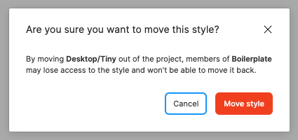

While trying to reproduce the problem with another working file and library, I was prompted with a dialog warning about the consequences of the action of moving a style out of the library:
CleanShot 2021-12-28 at 14.47.58
I don’t know why this dialog didn’t appear on the other library. Maybe because the working file is the only one using the design library file?
