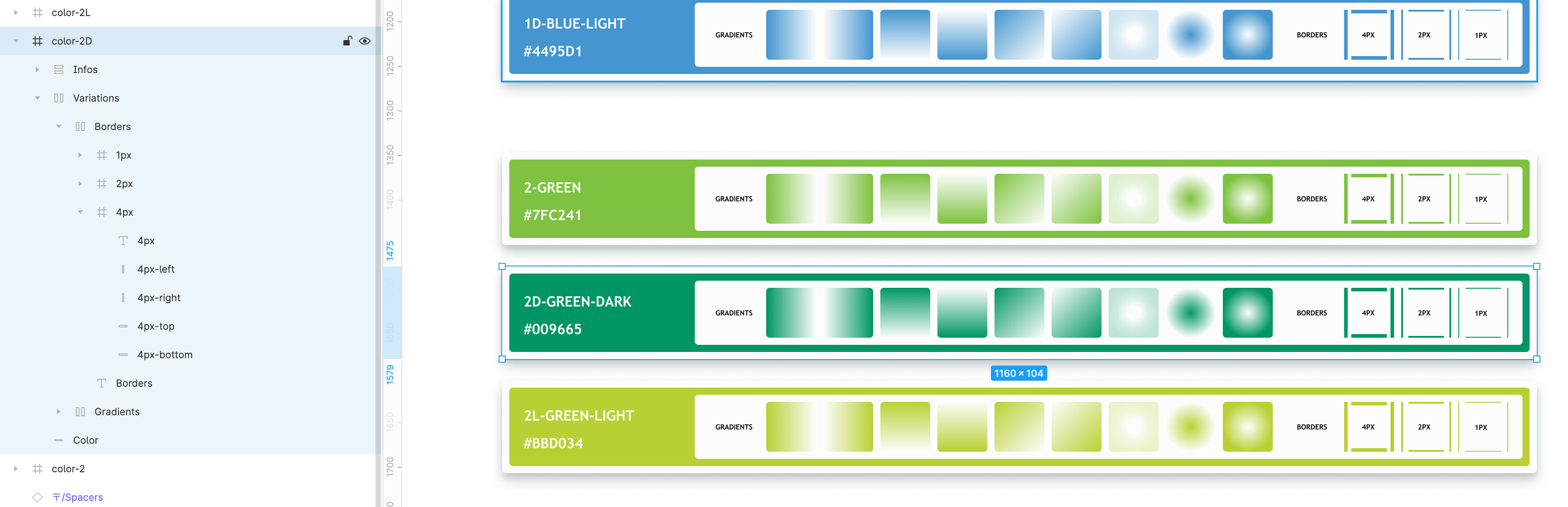

To my mind you can’t help me with my workflow… because it’s linked to the fact that Figma doesn’t keep the original style in a time capsule when it is modified (the little * in sketch.app)
So I can’t expect to update anything … there are no tracks of modifications, every style have been broken
For example in my screenshot
If I change the green, figma breaks the link to the style
And if I understand, your advice, I have to rename my border left 4px
from [4px-left] to [Color-2D/Variations/Borders/left/4px] ?
Andrei_Iancu
Thank you very much for the feedback! ✌️
This is a very interesting approach for the styles!
Unfortunately, Styler doesn’t work with nested layers, but it would be a very interesting feature!
There are few issues in implementing such a feature. 🤔
For example, layout grids can be found on frames and components, so it cannot be a way to get the structure/naming of the style.
So a short answer would be, yes, you would have to rename the layer that contains the styles as you said and select those layers when you use Generate.
Something that I believe I forgot to mention in the description of the plugin is that people should not try to update and rename selected layer’s style in one go because the match is made by one of those 2 factors (name or attached style).
