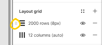

Barry_Keenam
I just figured it out. in the image i uploaded you want to hover your mouse just to the left of the grid icons (on the grid you want to copy) then you would see a “sandwich” stack icon pop up. you can now ctrl or shift click that to select the grid and then you can copy and paste. I do hope it made sense.
