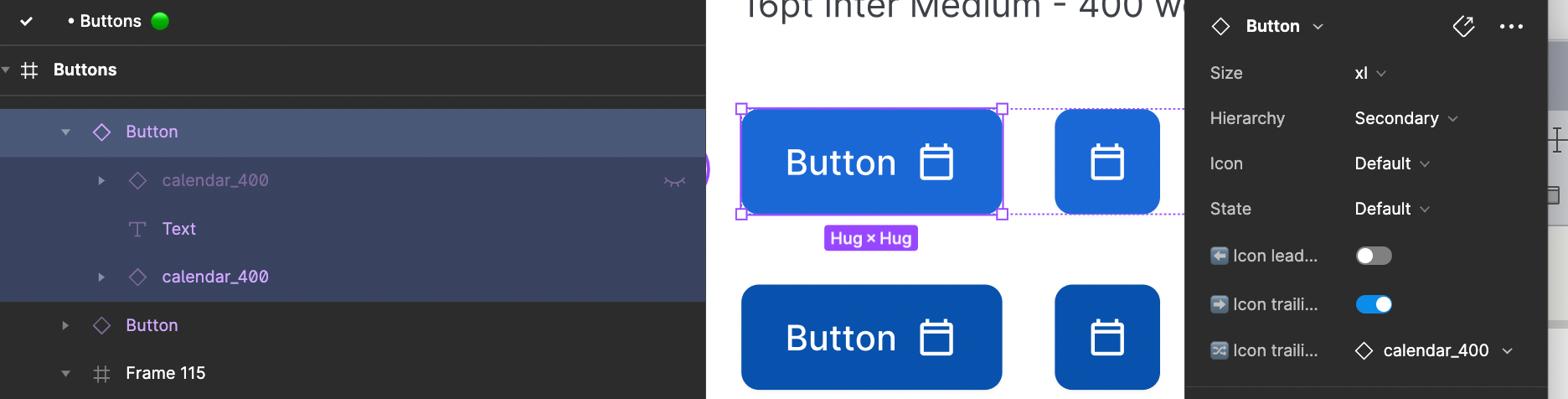

zachtalogy
Try pressing the “Go to main component” button in the properties panel. This should take you to the original file. You can then share the link to your client so they can find it.

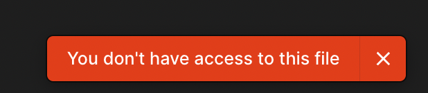

grahamhumphrys
Screenshot 2022-11-04 at 17.30.00
Yeah, that’s the whole problem the client can’t locate the original component. Therefore I am only left with the parent components.
zachtalogy
Hmm so the button isn’t taking you to the file, and then giving you the error? It just throws the error in your file?
